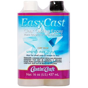

How about this stuff?
http://mobile.walmart.com/m/phoenix;...16oz./12356345
Your link doesn't work on my PC Cusefan78
Sorry here's a photo of it.
Attachment 12800
