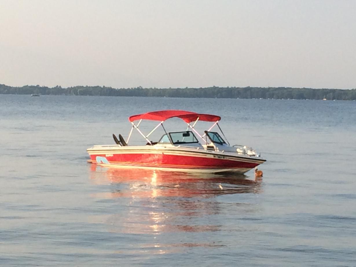

I uploaded some pics to my profile. One pic shows the rot I found on the seat bases in the rear, which I recently rebuilt. I also rebuilt the step in between the rear seats and the base frame for the engine compartment. Floors feel pretty solid except between the cooler and the ski pylon. I did the "thump" test on the rest. Haven't drilled the main stingers yet.
Luke, Take a look at this pic. Does it look like my boat is heavy at the waterline? It has normal gear in it as it sits. Thanks, Micahhttps://forum.supraboats.com/asset.php?fid=14114&uid=29441&d=1437020115Attachment 16081
