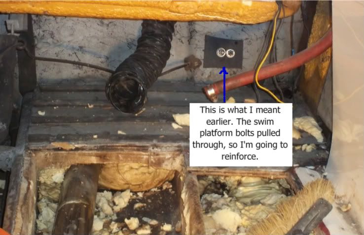

When I climbed onto the platform last year, the upper bolts pulled through, which was the first evidence of a problem. When I pulled the tank, I saw that there were small blocks (about 3x3in) flush to the inner transom where each bracket bolt went through. I decided to replace those with larger brass blocks cushioned with a rubber mat and multiple washers in varying size (like a cone aft to front) to disperse the force against the transom. I'm way behind in the project, but will show the pics once it's done. Looking great so far...you're gonna have a brand new boat when you're done!

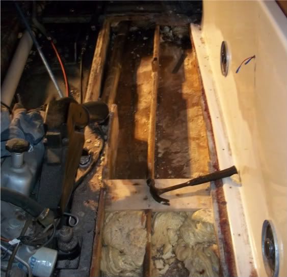

Although I'm way behind, I finally got some work done:
Floor being removed:
http://i914.photobucket.com/albums/a...100_0103-2.jpg

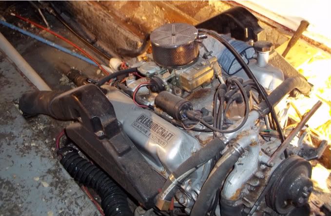

Met with the mechanic today. Although I had no plans to mess with it, looks like I'm going to have over 300hp!!
http://i914.photobucket.com/albums/a...100_0102-1.jpg
Rlhahn: This what I meant by reinforcing the bolts for the swim platform against the transom
http://i914.photobucket.com/albums/a...100_0099-1.jpg
Any suggestions on a quick way to remove the foam?

Foam removal is tough...straight shovel, chisel, air chisel, dynamite ;-)
Ahhh. Mine does have plates, but they still move quite a bit. I think I'm going to try and manufacture one long plate that connects all three supports.
As far as the foam goes, I used a sawsall (w/ a long blade), and then an orbital sander with 60 grit. It's messy though. My son helped by holding the shop vac hose while I worked.
