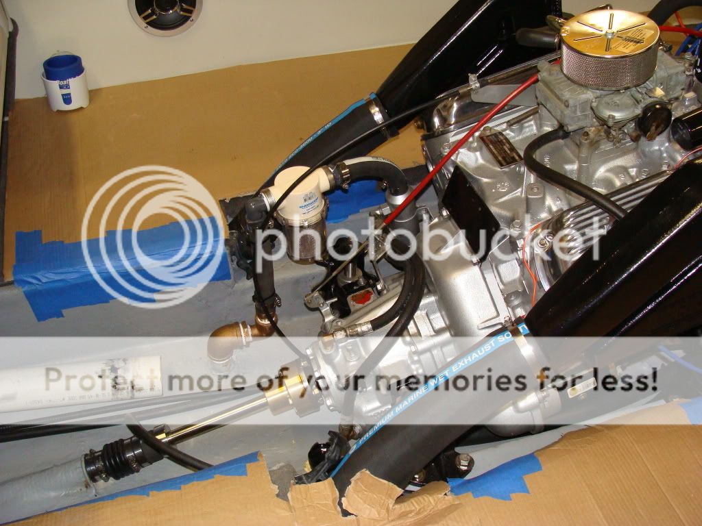

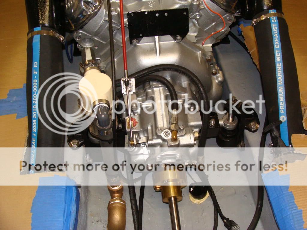

A little more progress. The new strainer is installed (this is an addition) and all the plumbing is finished. Now I will move on to wiring the motor.

Strainer and inlet hoses/fittings

Thanks for the head's up on getting two clamps to fit at the rear of the PSS and shaft log. I checked mine & had to grind a little gel off the bottom of the log opening, but now the bellows slides on square & two clamps fit. Thanks again.
Nice job on the strainer. Have you checked to make sure it'll clear the doghouse? Mine was originally tilted at an angle to clear the storage box at the rear of the engine cover (but I've got a big block & things are a little tighter under there).
Man, that engine, bilge, heck everything looks sharp. Great work & inspiration.
Edit - just saw your other post where you checked for strainer clearance. Glad you beat me to it.
Looks really good Clint!
You should name her "All Out" cause man you went ALL OUT! :)

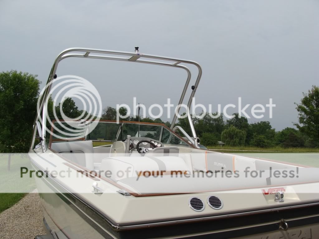

OK Dusty - you asked for it ( I love to share pics of my baby!) - these are some from last year (phase 1) rebuild. The pictures are buried somewhere on this forum . .
Here's a few of the interior.
