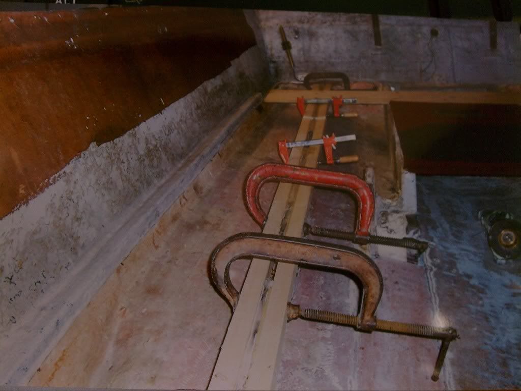

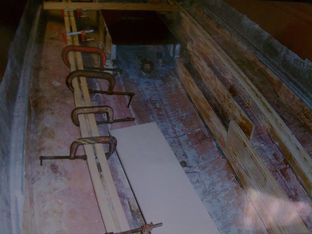

A few more
http://i1112.photobucket.com/albums/...n/IMAG0412.jpg
http://i1112.photobucket.com/albums/...n/IMAG0416.jpg
Looking good. When he says done this weekend, does that just mean with the stringer portion, or everything?
Im assuming done with everything. He was talking about laying the deck in on Sunday and then spraying the gelcoat later in the week. However he has been saying the same thing for the past month, so we will see. He is almost 2 months behind schedule, but I would rather it be done right and take longer than half assed and done quickly. We will see though. I forgot to mention that we are putting some foam back in the boat. We will fill the cavity between the outer stringers and hull with foam for floatation reasons.
