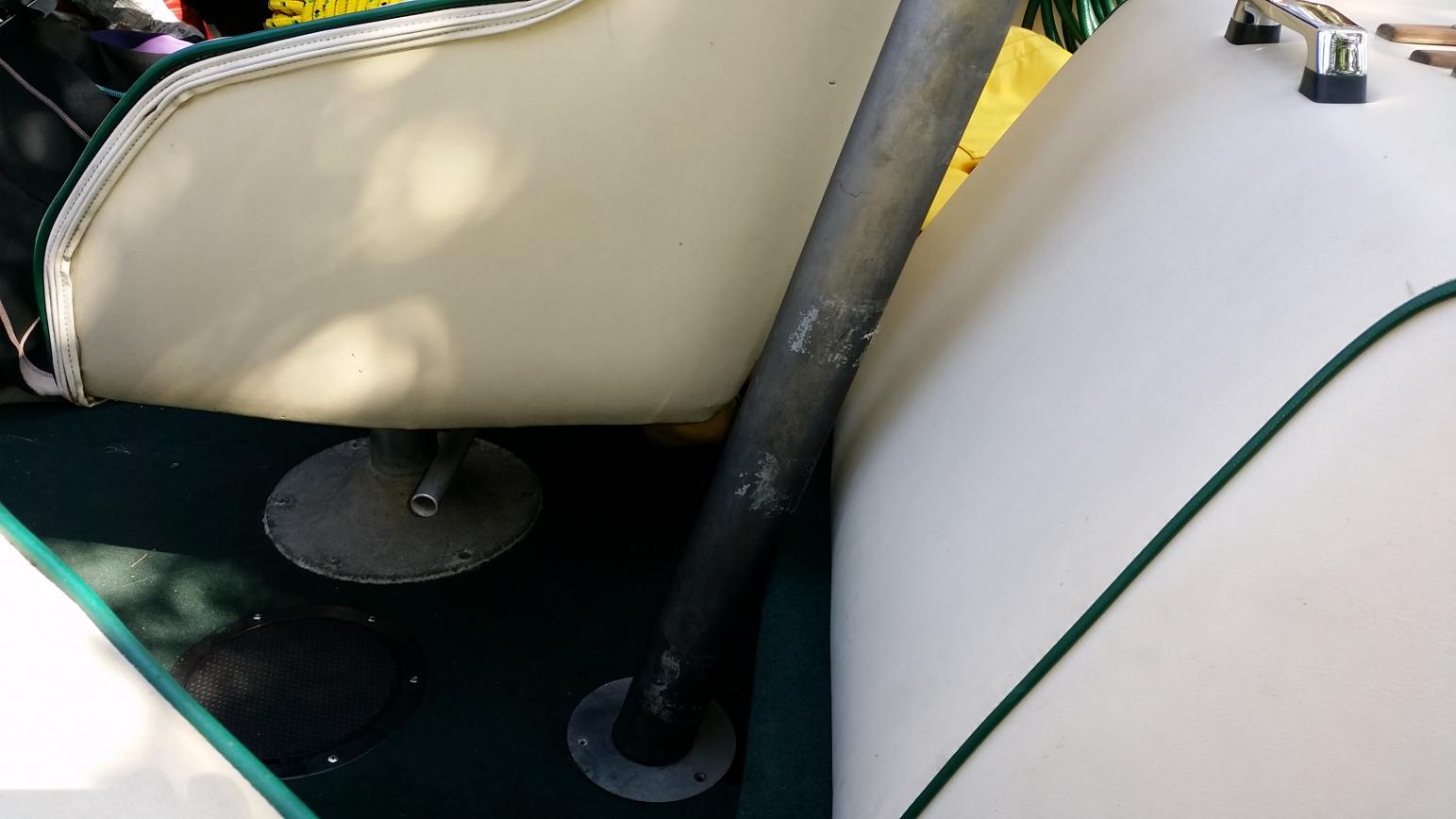

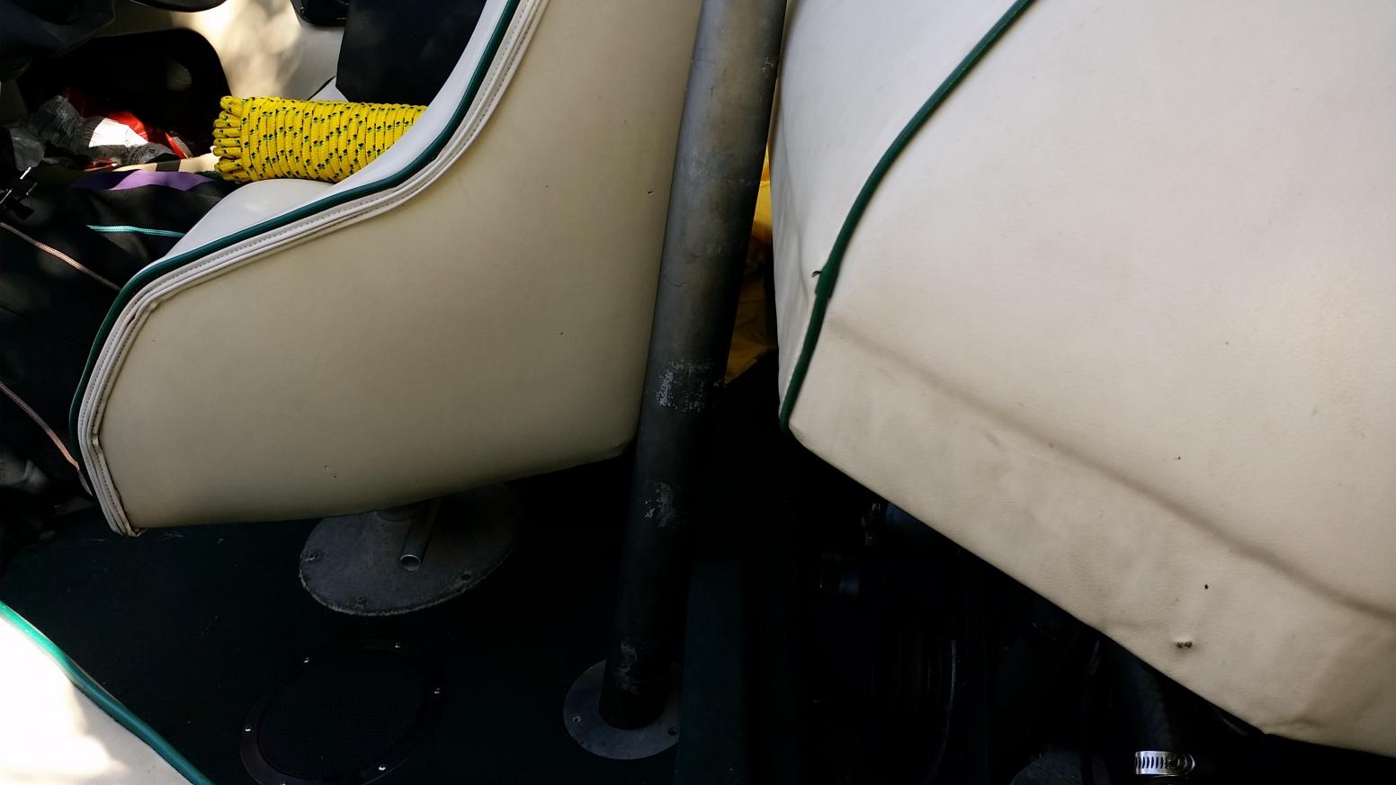

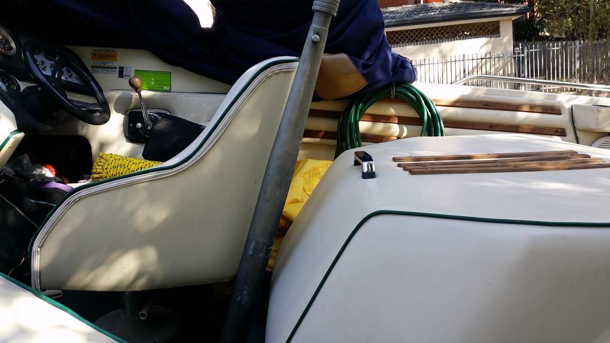

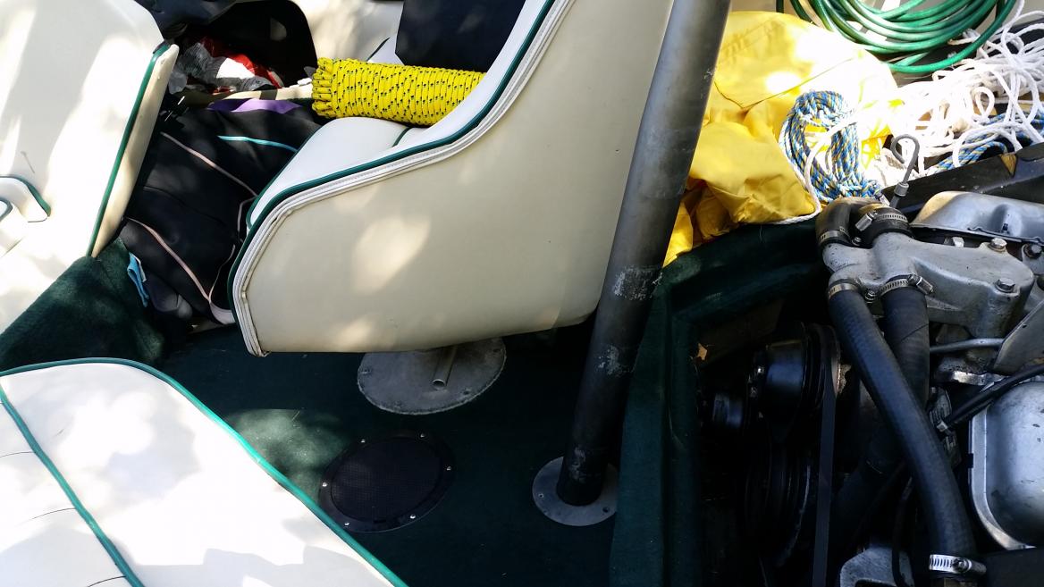

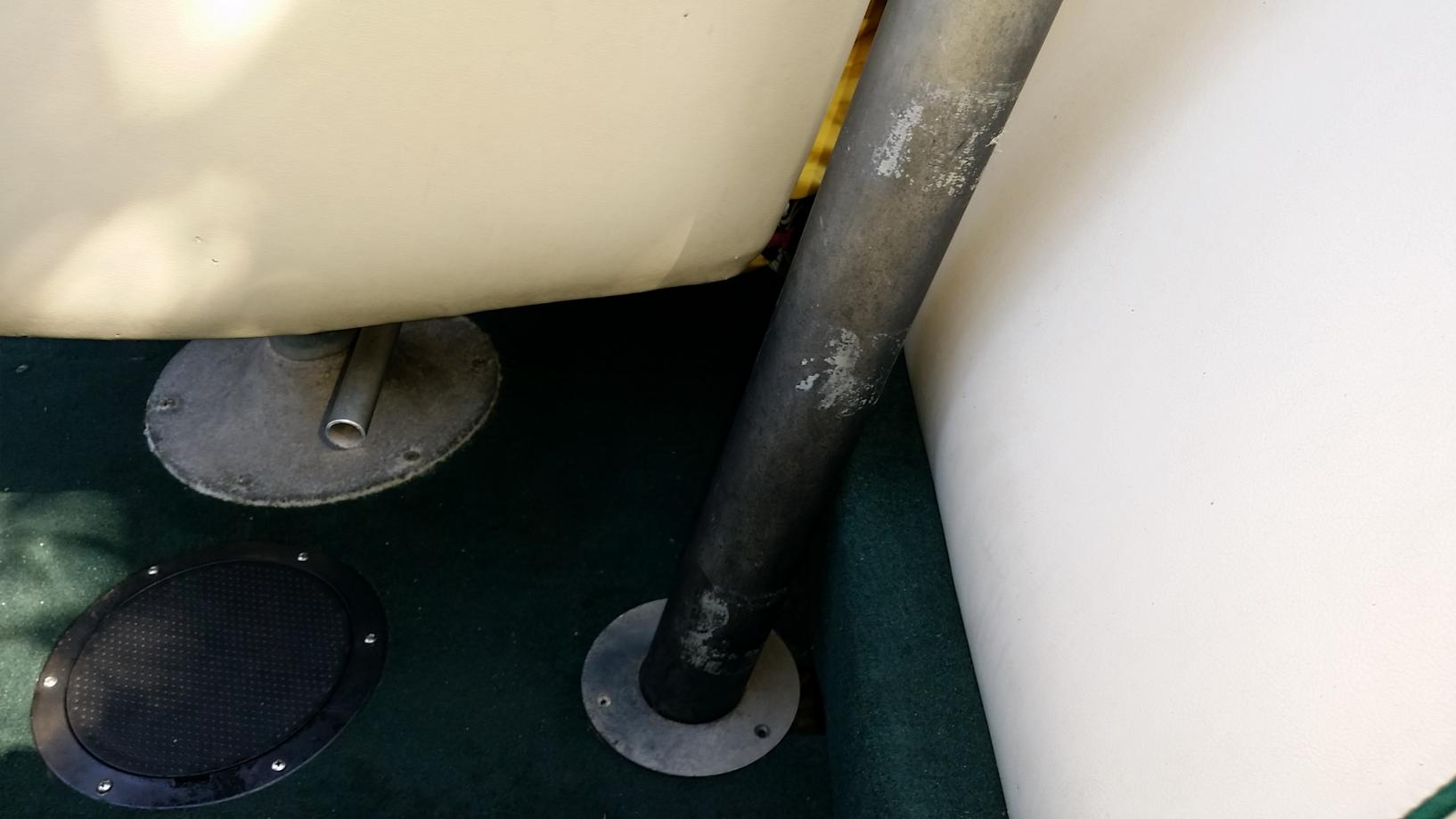

I'm working on the boat this week so I can take photos and measurements if you like.
Attachment 17506
Attachment 17507
Attachment 17508
Attachment 17509
Attachment 17510
Ski pole is at the same angle as the back of the drivers seat. The motor box touches the pole at the floor and when I open the motor cover the lid just touches up against the pole.
Hope these pics help.
Cheers
Jason
That's pretty much how mine is. My base is not attached to the floor, so I just slid the base back before lifting the cover.
Thanks. I guess I will just carpet the engine box base, install the pylon and leave the screws out so I can also move the base around to open and close the box.
