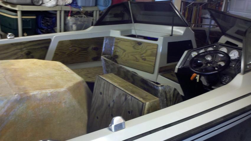

Ready to head to the upholsterer - once the better half blesses the colors and design (could be a major delay). Carpeted the seat bases & bolted in. The rear bench is "convertible" like the Outback so it can sit down on the base as a seat (with room for ballast bags half full), or raised up level with the ski locker lid for double the sundeck (full ballast underneath) - hence the funky looking arm rests. The rear bench ended up being too wide to handle & clear the cupholders and engine cover - so, split it in half. Once the interior is done, I'll fab some hinged supports under each half to support the middle cut edges in the "up" position.

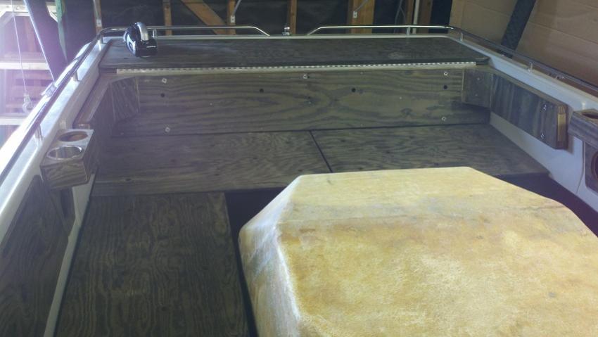

Here's the rear facing chaise. The base is 72" long for ski storage. The backrest is hinged at the top to access a small storage pod. Made new speaker/cup pods so I could use 3-1/2" s/s cup holders (gotta fit coozies to keep the beverages cool...)

All my original corners were rotten where the seat back bottom met the base, so I went with separate bases and backrests to let things breath (plus I probably couldn't have matched the factory angles). Kept the loveseat design, but put it on slides on a box base with storage underneath.

Kept the backrests high in the bow as well so the bottoms will slide in underneath (another rot spot for my originals).

Fabbed a new bow storage locker out of black Starboard -hinged and slam latch. Thinking about pulling the trianular teak trim pieces off of the original and putting on the new. Would help keep a little of her heratige bow to stern (pod trim, doghouse hatch, swim platform) and keep the black from burning bare feet as badly. Wadda ya'll think - teak or no?

I had to make the rear bench seat back and armrests extra wide to support the edges of the seat bottoms when "up" since the hull tapers out at the top. Once the final height is set with the upholstery, I'll add some hinged panels to the underside of the seat bottoms that fold down to support the inner edges - fronts will remain open. I've got 2 MC X-2 sacs (450# each) that fit underneath - half full with the seat bottoms down, full sacs in the "extended sundeck" mode.

Jet - hey, I still ski till my bum back gives out & then switch to the boards. The rear bench back/armrest assembly is a 1/2" ply and 2x2 truss, glued & screwed, then through bolted to two 2x4's that span port/starboard and to the sides - hopefully, it won't sag!
Cad - Originally I had planned on a one piece rear bench bottom that lifted up like on the Outback. However once assembled, I couldn't move it up top because the armrests, cupholders, and engine cover had it trapped like you said. I had to split the seat into two pieces, but that left the center unsupported. Once the final elevations are set from the upholstery, my plan is to add some support panels hinged to the bottom side of the seats that fold down from the inner edges to support them off the floor. Adapt, improvise, & overcome (I hope?). I moved my batteries up under the port storage like you mentioned - cut an access panel behind the observer seat base and glassed in a wall to separate the batteries from the remaining bow storage and sac that will be underneath that dry storage area. The backside of my observer seat base is mostly open & could probably reach the batteries for a jump if I needed to, or now that the bases are separate from the seat backs - remove 2 bolts and the base lifts out for full battery access.
