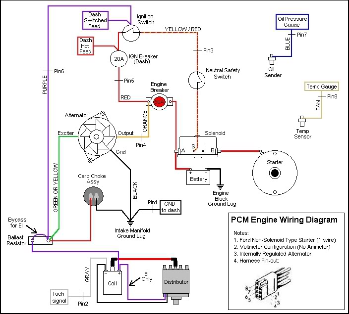

So how should this thing be wired? I have it setup as it's been since I've owned it, but that doesn't mean it's right. I just replaced the 3 wire alternator with a one wire - 105 amp alternator. This hotter alternator might be creating some issues. So my battery cable comes back to the solenoid on the starter and the main wire bundle from the breaker attaches to the same post. There is a small wire that attaches to the ignition post on the solenoid. That's it. I have a remote solenoid next to the breaker that isn't doing anything. Someone has by-passed it at some point. And while the distributor is electronic (no points), the ballast resistor is still wired in. What is the suggested setup based on these facts?
Pretty sure that you don't need the ballast resistor with the electronic dizzy, but you'll want to double-check that based on what dizzy you are using.

So one theory I have is that the new 105 amp alternator is heating up the starter with the wiring setup the way it is. Basically I have a solenoid on the starter and a remote one next to the main circuit breaker. The one next to the circuit breaker wasn't being used at all. Everything was connected at the starter which meant that the alternator was sending the charge through the solenoid on the starter. I've rewired it like the attached diagram, which includes bypassing the resistor. This may not be the problem, but I think this is a more accurate setup and isolates the starter from the alternator. So if this isn't it, I'm thinking something is wrong with the starter.
Attachment 13963

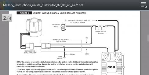

If it's not a Mallory Unilite distributor disregard this but if it is read the statement on the attached diagram. I would agree that your alternator is causing the problem. It sounds as though that is all you have changed. If everything was working correctly before the alternator change to a single wire then it sounds like that's what's created the issue. I just want to point out the warning from Mallory on the ballast resistor so that you don't possibly cause yourself another problem trying to fix another. Either way good luck with it. Attachment 13964
the wiring looks standard...

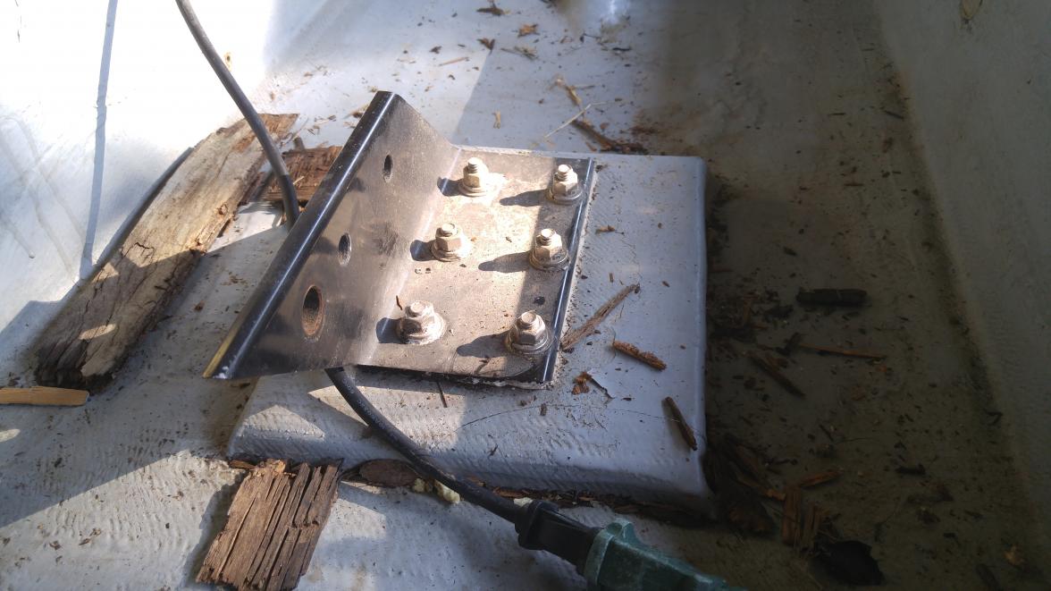

3. Do you have a picture of what went down where the water intake (fresh water intake fitting that is through-hull) is? I have a few bolt holes in a square pattern that surround that inlet. Unfortunately whatever was there to begin with was removed before I started the project. I am including a picture for a little more insight.
