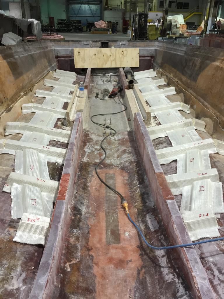

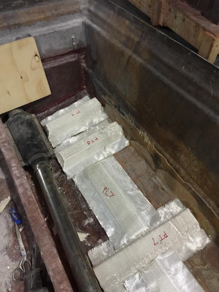

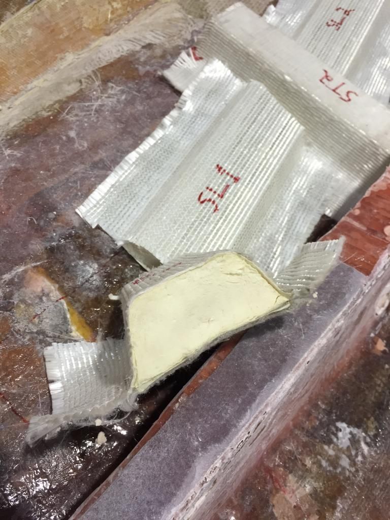

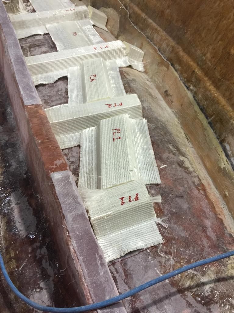

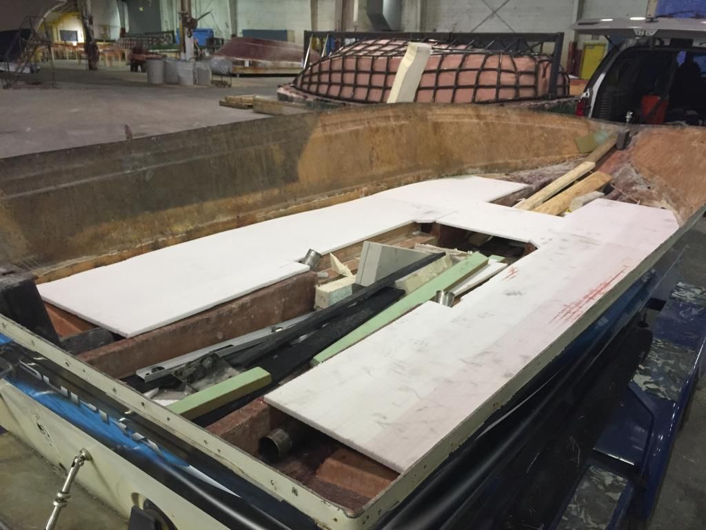

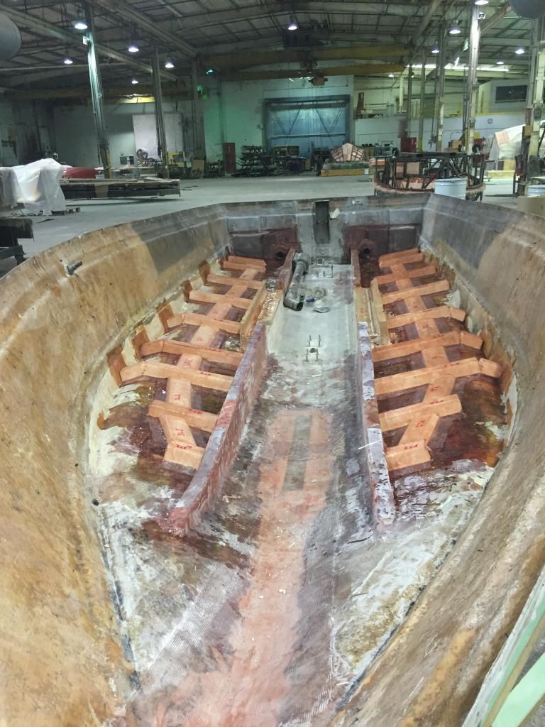

I am using these beams as for my outer stringers and wings. I still have to make my wedges to the shape of the deck. I'll glass these in first. The main longitudinal stringers and any wedges that will be receiving screws from securing the deck will have a layer of trevira glassed in to do be able to do so.

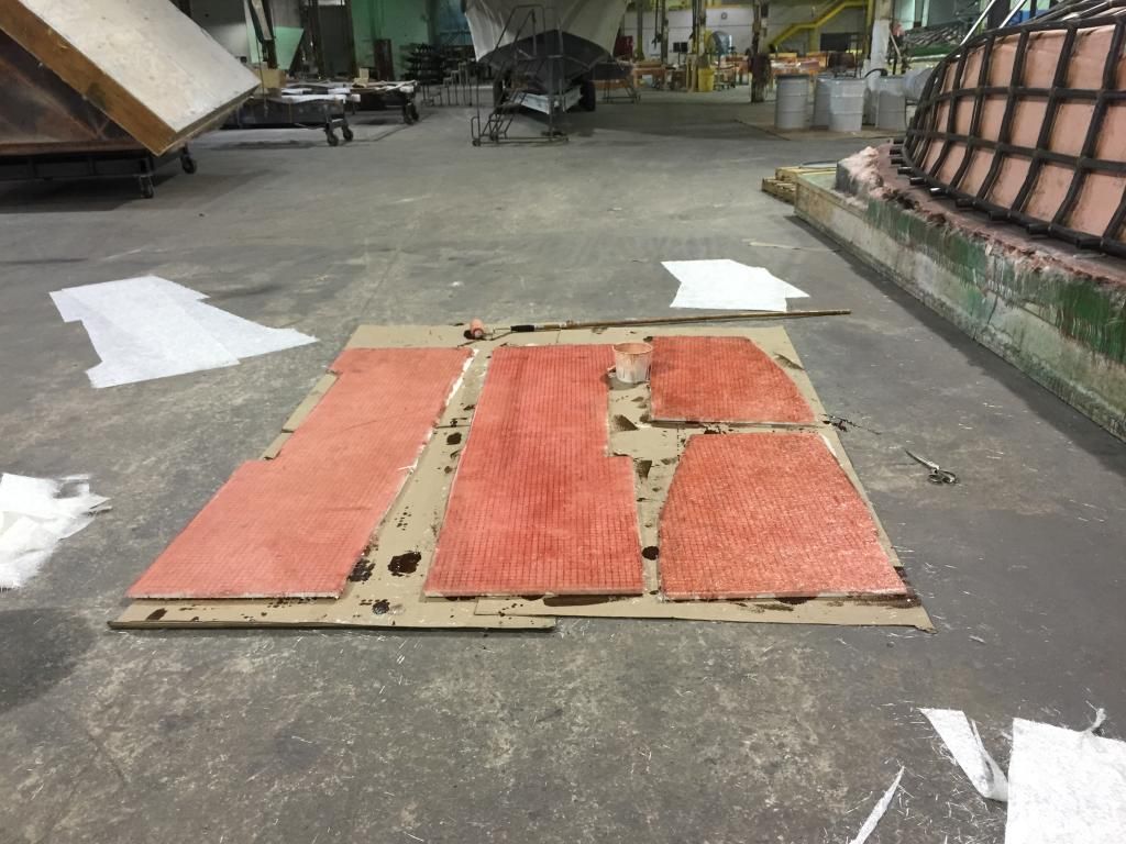

Here is my dry fit layout. To get a good bond to the hull, I am using a 36 grit sander to scuff the contact areas. I am also laying down a 2 oz csm to embed these preforms. All the stringers will be covered with a final layer of 3610.
