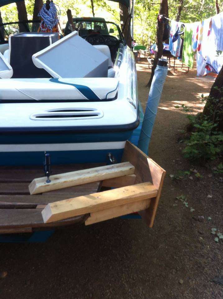

Here's the bracket. The two plates clamp onto the teak, the larger one clamping to the wood, the smaller one clamping to the bracket. The two bolts allow wooden plates to be swapped out easily on the water. The white paper is a tracing of the hull.
http://i6.photobucket.com/albums/y22...ps0dcbf63d.jpg
Here's the bracket clamped into place, with a wooden plate bolted in place.
http://i6.photobucket.com/albums/y22...psf0b48994.jpg
To find the best plate, I cut out several of them so I can swap them out on the water. When I find the best one, I can fine tune it...
http://i6.photobucket.com/albums/y22...ps81e86a97.jpg
