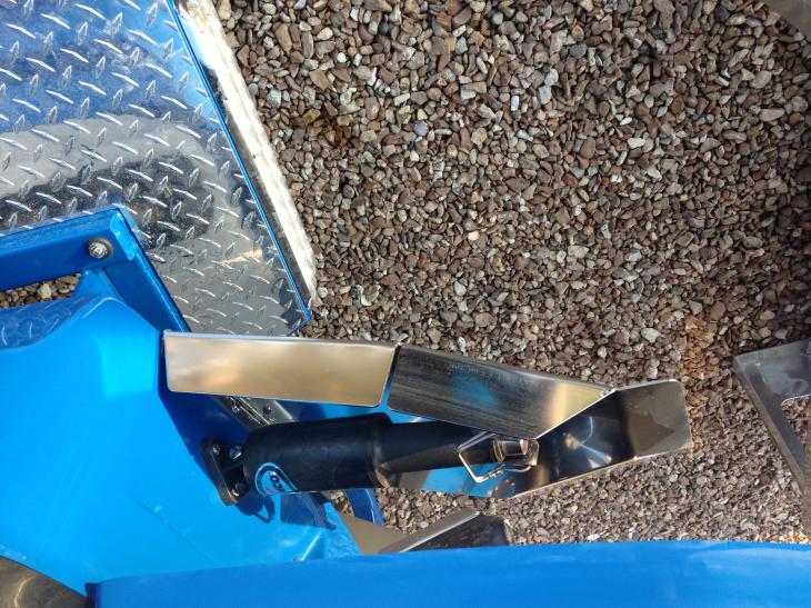

Here. I made these this spring. Attachment 15705Attachment 15705
It should work fine. Finishing up a few final things and hopefully by the weekend test it. It should work fine. The principle is to delay convergence. The boat already has a really nice wave. Size and shape. This hopefully will make it so I will not have to weight the boat to one side. Makes things for convenient
As far as control system I'm using the lenco trim switch with the led indicator lights. Eventually I'm going to make a control system using a frequency analyzer to pick up the paddle wheel wave form. Put a pot on it to adjust the the frequency for them to kick another circuit to auto retract them over 15 mph.
I have videos coming. It works perfect. Both sides and switches fast. Awesome push and size running 400lb stock tank with an 800 lb sac on each side on the engine. Only two people in the boat. Attachment 15712Attachment 15713
The pics are just from 400lbs stock ballast filled
Looks pretty sweet, Your design is exactly what i was talking about earlier in this thread. Glad it works well.
