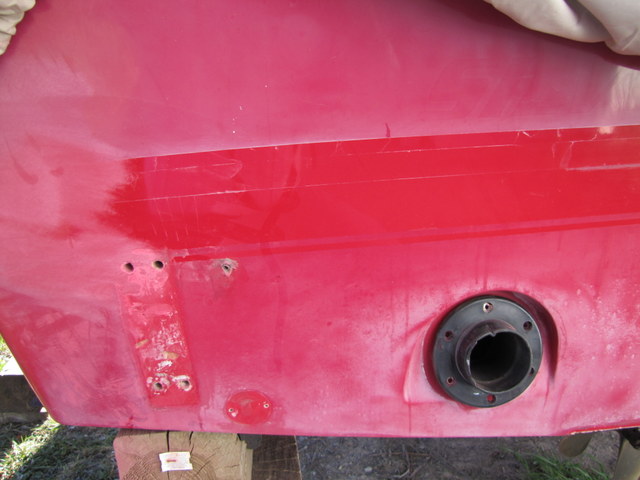

Here are some pics for you Century.

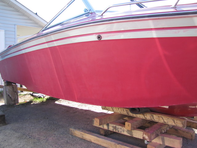

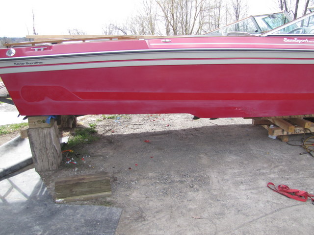

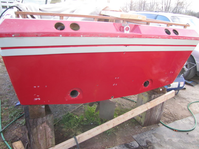

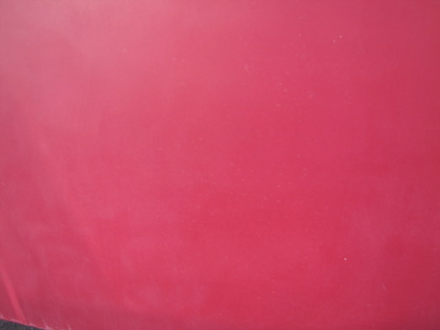

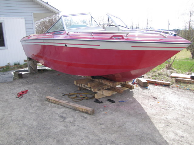

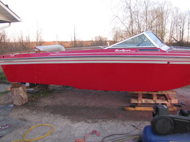

This is the scoring I was talking about I will say that the right side of the boat seems to be coming off easier I'm using 220 on the electric orbital.

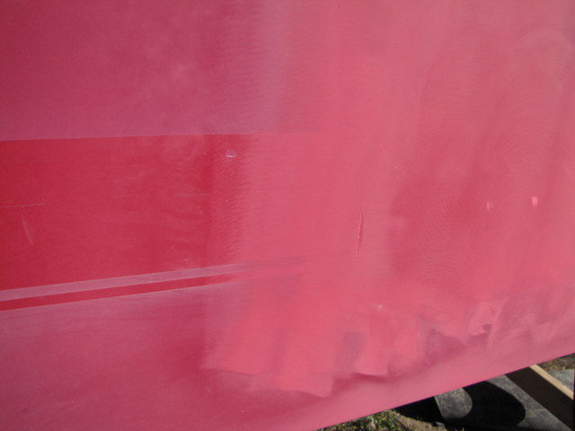

Attachment 9344Attachment 9345

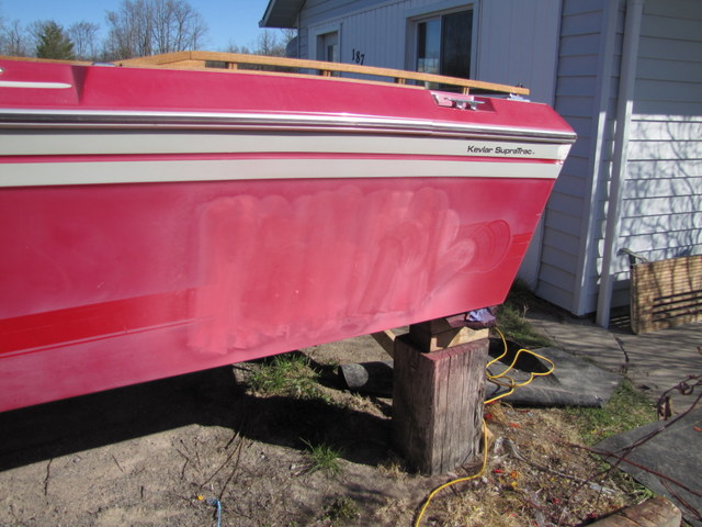

This section took about a minute to rough although it's not completely done

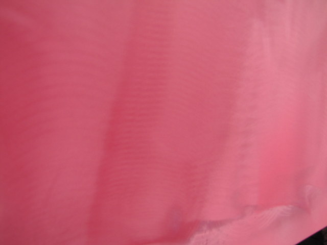

Attachment 9346

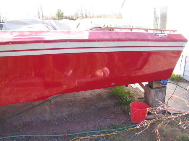

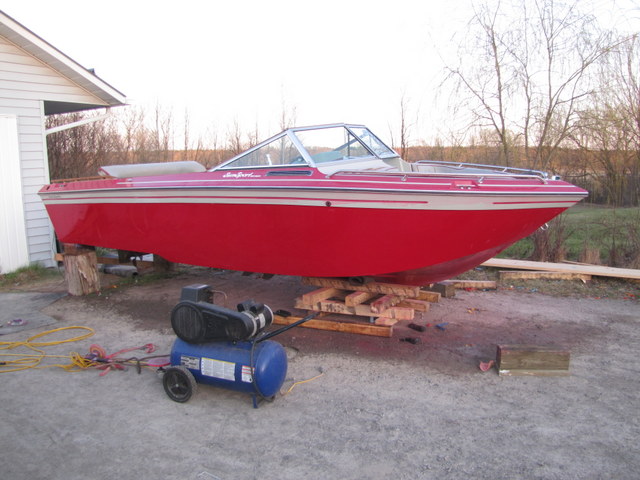

Then I sand with my Air sander with 150 to get the swirls out and get this
Attachment 9347Attachment 9348
I want to rough the rest of the hull like this before I more up to the next grit. After I rough it I wipe it down with a rag and water sand it with the 150 then wipe it down again. This way if I miss any swirls I can see the and after it dries go over that spot again.
