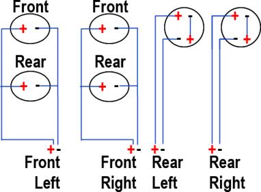

Since the Alpine PDX F6 is a 4 channel amp, how would you wire into the 4 channels with essentially the 6 speakers (4 xs-60's and 2 pro-60's) ?
One Pro 60 on channel 1. One Pro 60 on channel 2. Two xs65's wired in parallel on channel 3. Two xs65's wired in parallel on channel 4.
Essentially like this...
Attachment 9446
