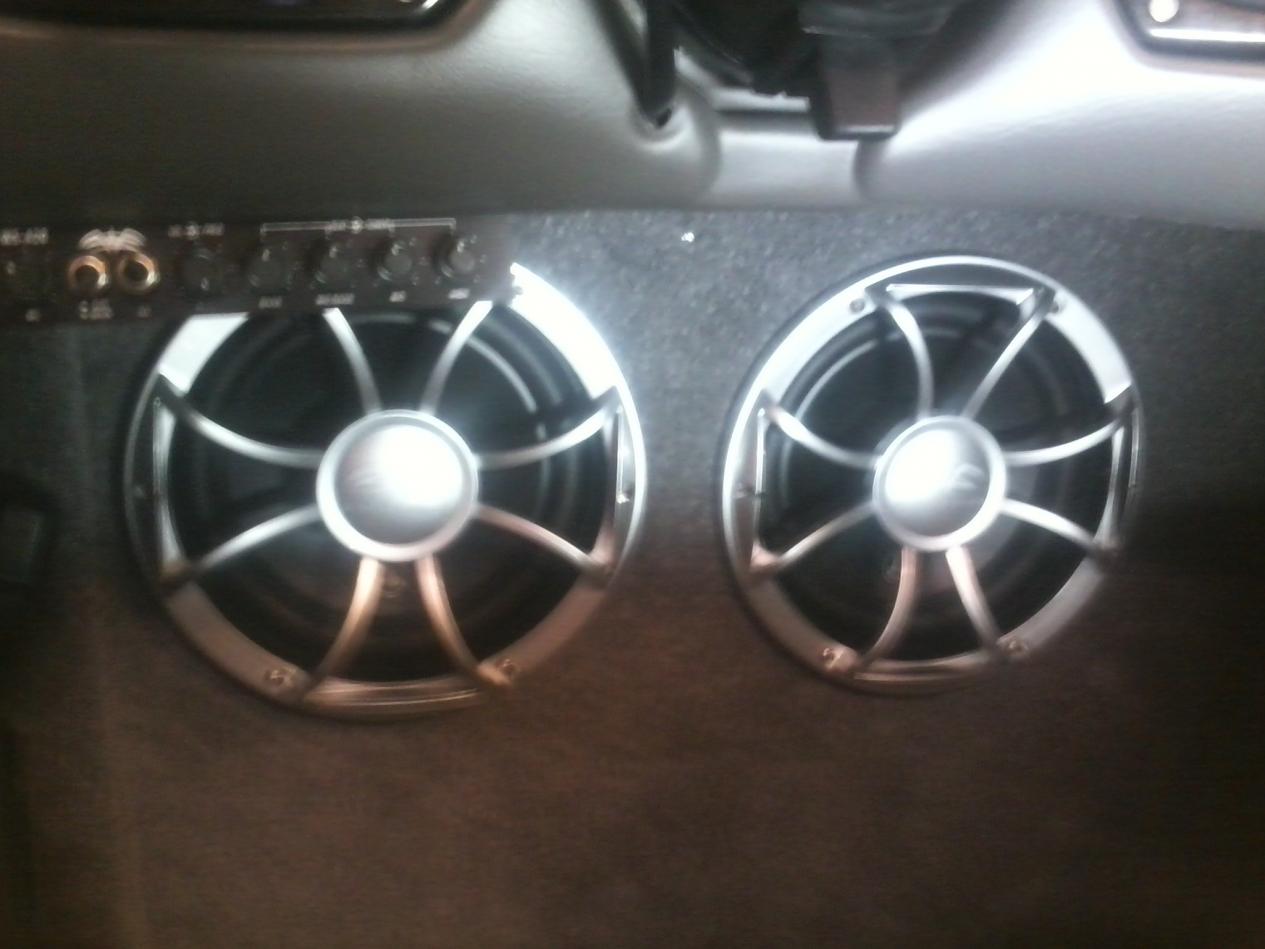

Attachment 11795 Here is a pic of two jl audio 10w3 under the drivers helm. It was a pain with the heater vents, heat exchanger and the hump on the floor that David was talking about. I still got .65 cu' for each sub. in a sealed enclosure. Lots of figuring and fabbing. Sounds great though. Just built a new front with factory carpet. Cheated with the wetsounds grill to match my cabin speakers and towers.

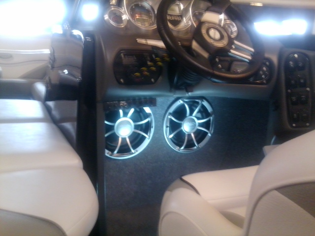

Attachment 11796 Here is a pic of 2 jl 10w3 subs under the drivers help. It was a pita with the heater vents, heat exchanger and the slopping floor. They are in a sealed enclosure at .65 cu' each. Took lots of figuring and fabbing but I think it turned out nice and sounds great. Just built a new false front and cheated with wetsounds grills to match my inboat speakers.
opps, thought the first one didn't post. Oh well second pic looks better I think
Looks pretty good Gene! Nice touch on the XS-10 grills!
