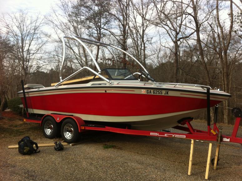

Attachment 11866
Looked great. Now time to put on the racks and mirror.
Very nice. What did you end up doing for the backing plates?
I used 5/4 decking with the aluminum backing plates it came with. I had to get longer stainless bolts but I preferred that over thinner board.
