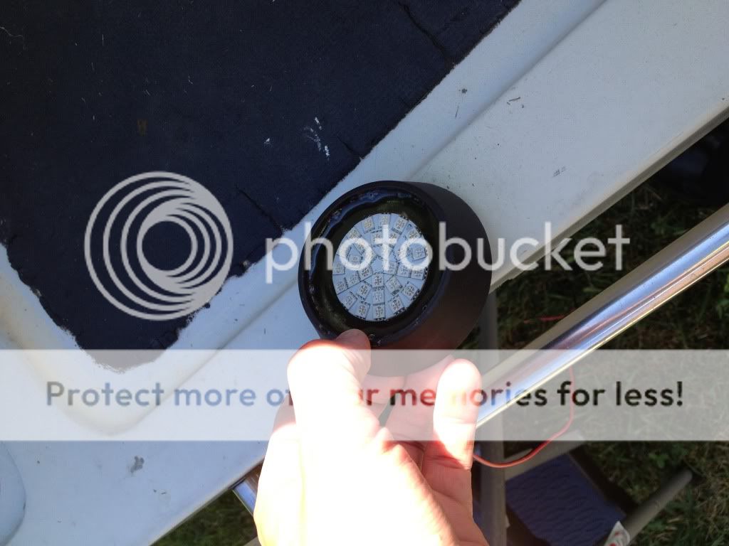

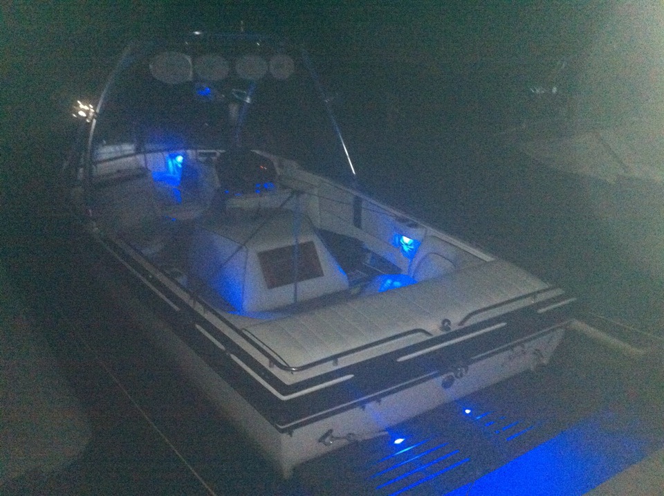

I just ordered 4. Can't wait to see how they turn out. You have pics of them in progress?
