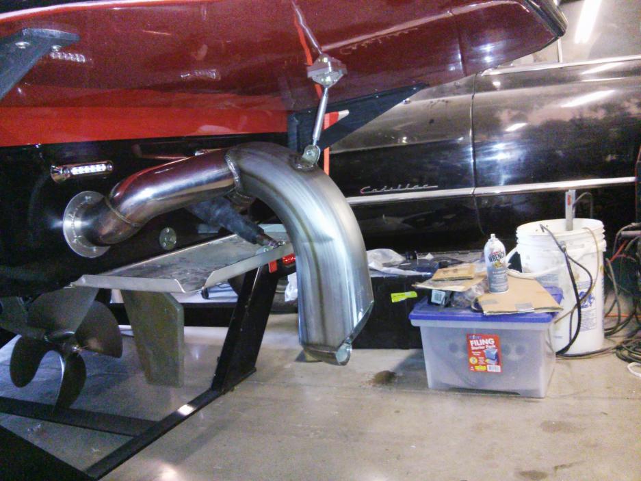

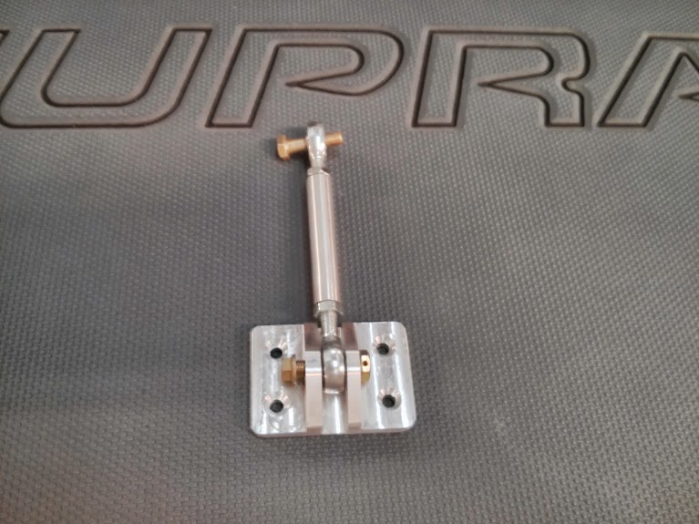

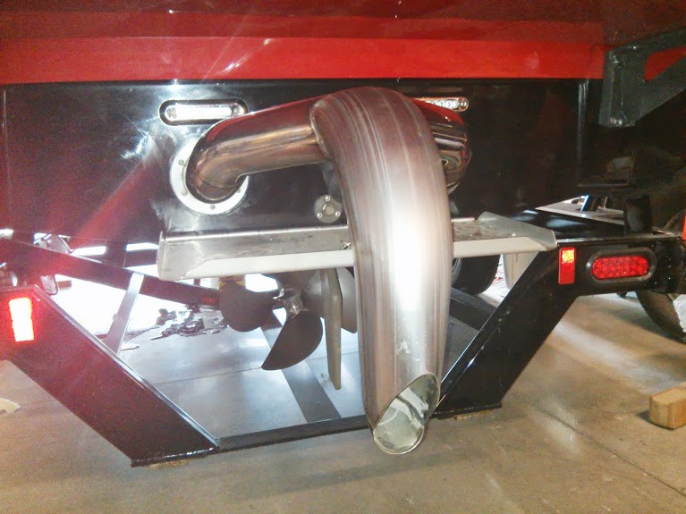

I made it. I had done some stainless pipes for it and used them as a starting point. They looked nice but didn't change the sound much. SO I cut them up and ordered a 5" 90 degree bend and made the downpipe. I made the bracket that's attached to the swim deck to brace it but after seeing the brilliant PVC one here I'm not so sure it was needed. I didn't bother with polishing it yet as I want to try it first and then the drudgery of polishing it up. The downpipe should polish like the rest of it.
Is it going to interfere with your transom LED at all you think?
That is possible, the front pipes are pretty polished so maybe they will reflect interestingly!!! Hadn't thought of that but having to get them up to clear the trim plate actuator sort of left me with limited options. We don't get out much at night which is a shame, we haven't even had a chance to turn on the LEDs this season. Have to find some time to this weekend just to see.
Thanks, I'm hoping we will like it. Here's a couple more pics
Attachment 12997
Attachment 12998
