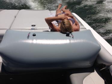

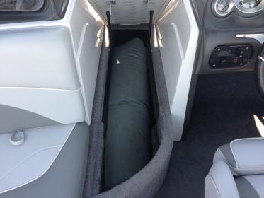

On that note, having a proper sized bag that can fully fill in the compartment it is in (and not relying on half filling it) is best. We run a 370 tube sack under the rear seat of a 92 Sunsport that only has space to fill up to about 250. We have forgot to turn the pump off and actually had it not only pop the seat cushions up, but also strip out the screws for the supports and bulge out the base of the seat. Interesting day when that happened, but educational. Still have it there, but now monitor it closely as it's easy to forget you left the pump on if you're not watching it until it's too late.
