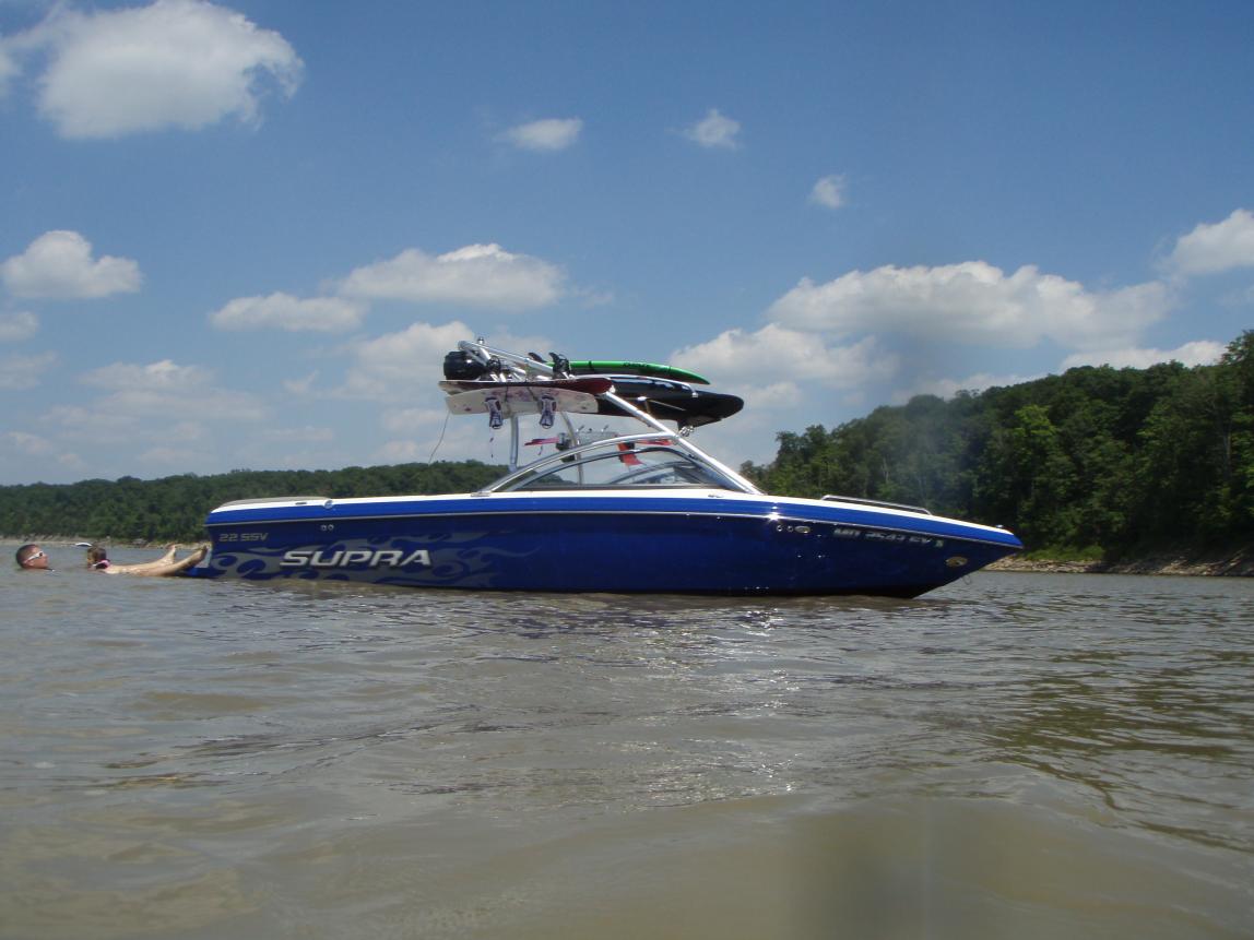

Thanks KG. I like all 3 versions, but really want the 15 or 16 person capacity vs 13 in the 21v. We have a Fam of 5 and often boat with friends/add'l Fam. Often tied up in a cove or at busy cliff areas at Table Rock Lake with kids so I can't have issues with swamping. By your pics I'm assuming it's a non-issue if my ballast are empty.
