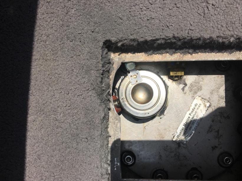

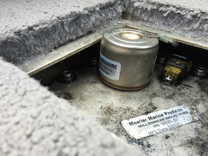

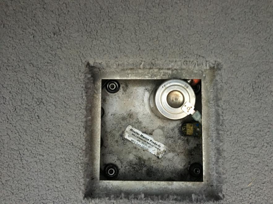

I have noticed the strong odor of gas after filling up the last few times. Today I did a little investigating to discover where it was coming from. As I finished filling the tank I checked the fill lines to the gas tank and no leak was noted. Then I removed the access panel in the floor above the fuel pump and saw gas pouring out where the fuel pump goes through the metal plate on top of the fuel tank. Called my local dealer and they informed me that the fuel pump is $650. That seems awfully steep. A little further investigation and I noticed that the fuel pump actually sits up a little higher than the floor frame so that the access panel actually pushes down on the pump when in place. Seems like a serious design flaw that will only cause the pump to eventually leak again. Anyone have experience with this?
