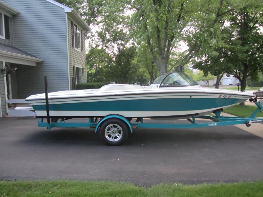

I had the exact lettering on my 96 and had the ghosting also when I removed. Ended up wet sanding to get it out
Did you get all the ghosting out ? I would rather not put those ugly things back on?
He did from what I could tell from seeing his boat a few times before he sold it.
Yes it all came out. Started by hand with 600 then 1000 then 1500. Then 3m heavy duty rubbing compound with buffer. Then gloss polish with buffer. Then wax with buffer. Wasn`t too hard since only doing the color and not the white. Attachment 18345
