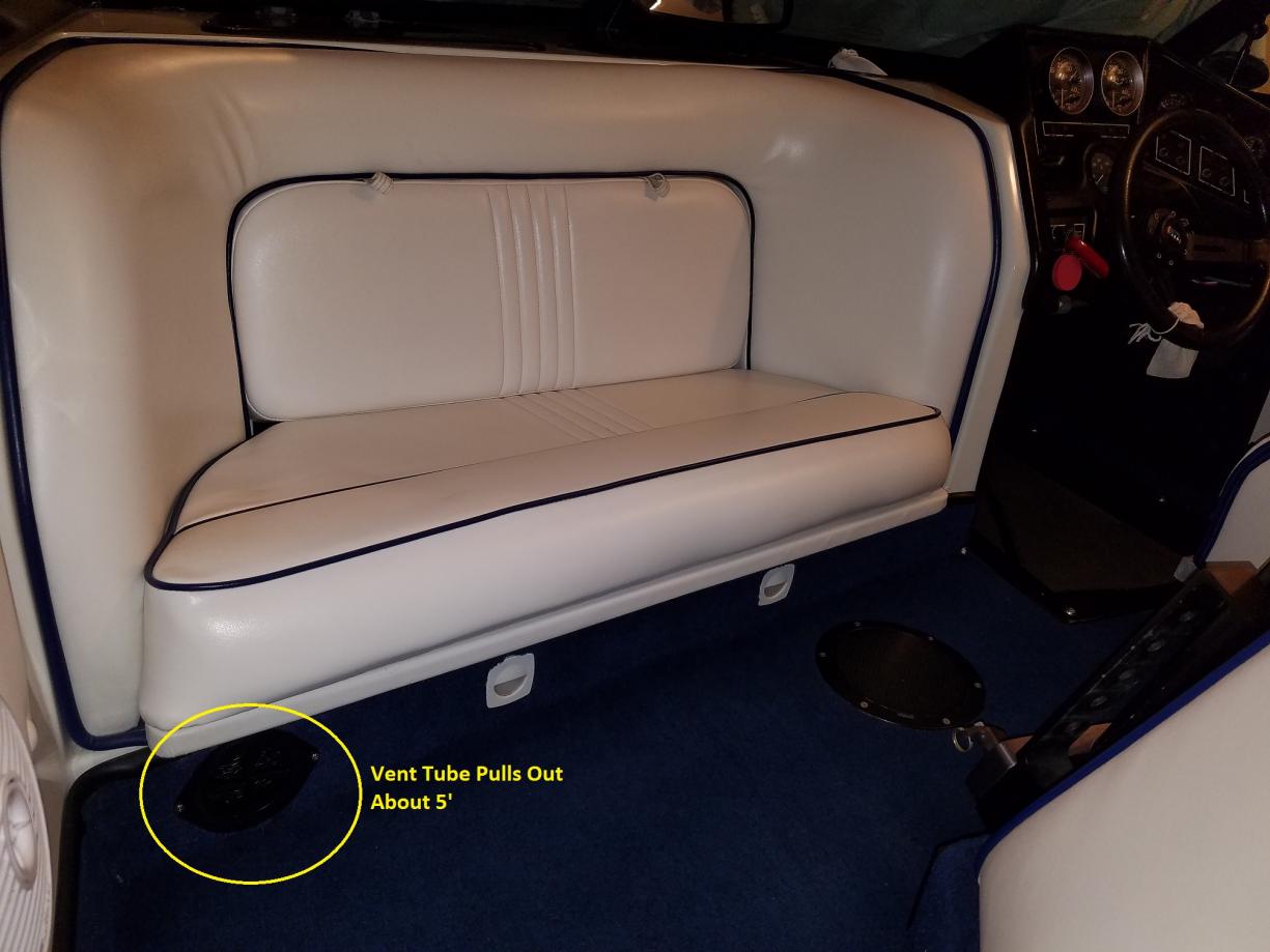

What did they do for the vent tubes that pull out? Where did they install everything, under the driver side dash? The spotter seat in my 89 Comp is pretty low and I don't think anything will fit under there. Did they make you a separate box to install everything in?
Attachment 18446
I do my own winterizing and think I may be able to do it but i'm not sure where the best place is for the heater core box and where I should put the vent tubes. Space I can't have the flex tubes in my ski locker up front. They will get torn up pulling skis in and out... Any ideas?Attachment 18447

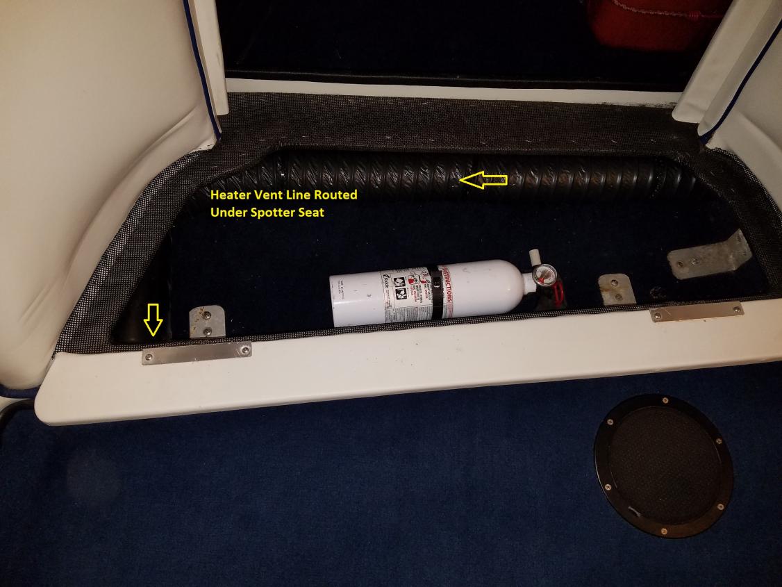

They ran one tube to the drivers side lower left in footwell area.
They ran one tube under spotters seat thru the storage area and made a clean circular cut out in the fibreglass seat frame just above the carpet floor where ones heal would be up against. In the storage area there is a metal tube that the flex plastic tube is manualy recoiled back into when not in use. On the outside of the fibreglass frame there is a black female ring that the flex tube with male end ring clips to when recessed. Easy peasy when using. In this way one can simply pull the flex tube out of the metal tube it sits within and bring it up to the spotter or skier needing warming etc. I had the third flex tube run up to the spotter cupholder on the dash just below the windshield to act as a defroster on those cool dew like mornings when trying to grab clean water for a ski.

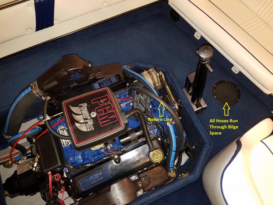

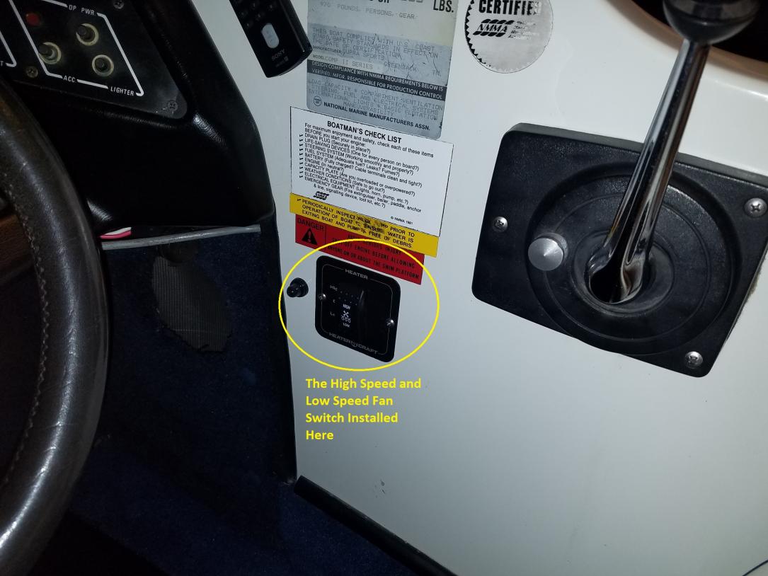

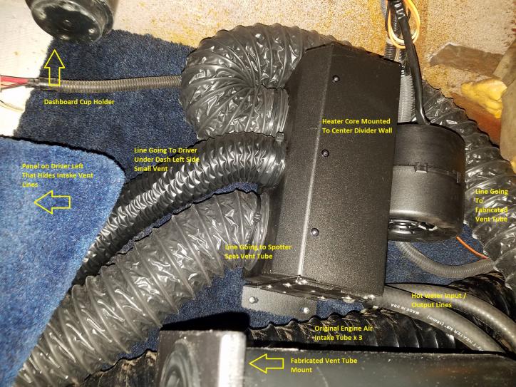

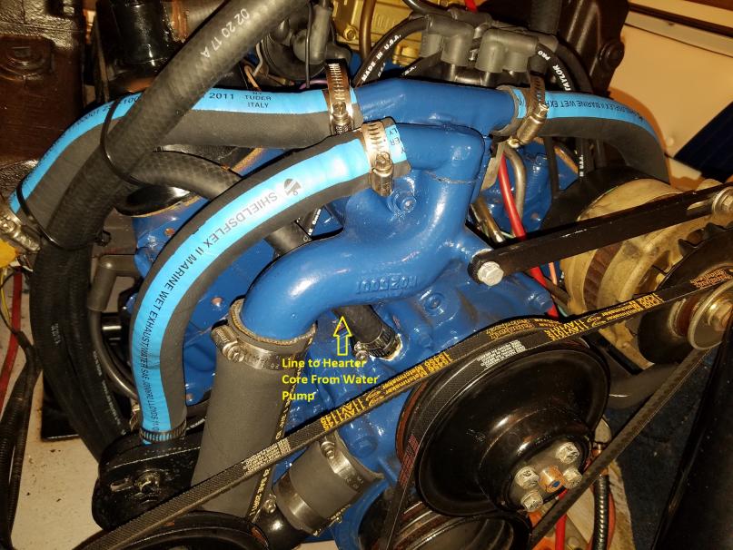

They did a great job. Here are a few pictures:Attachment 18465 Attachment 18466
