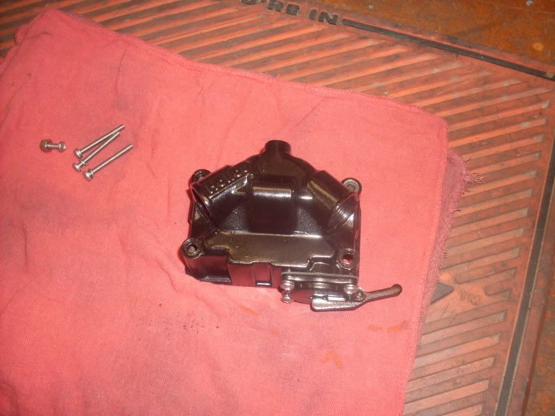

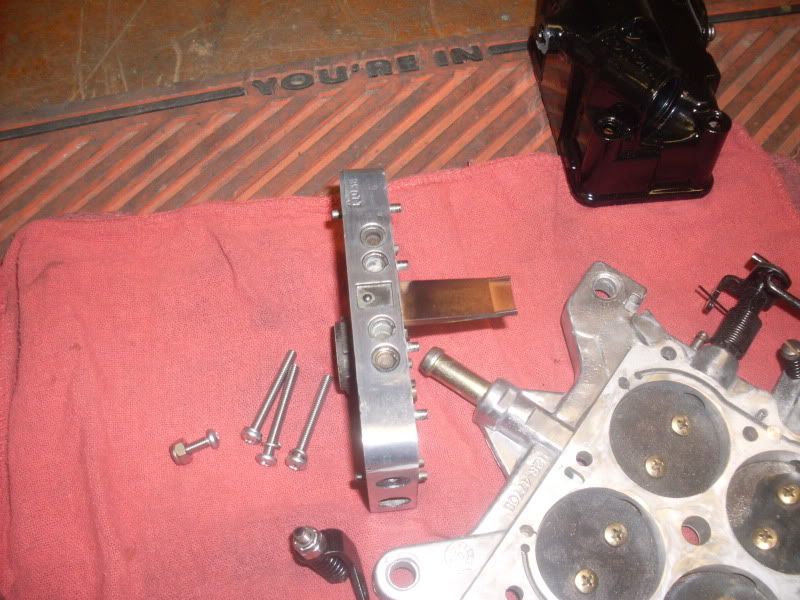

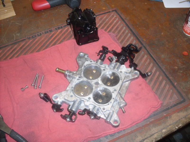

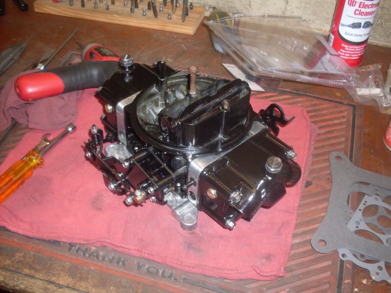

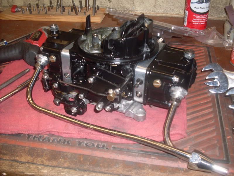

I don't have any pics of the 400 yet (it's nothing to look at anyway) but I do have some pics of my carb rebuild. So, here ya go...
Cleaned and Painted the float bowls. Lot's of time spent with a Dremel LOL!
http://i36.photobucket.com/albums/e9...s/SDC10508.jpg
Completely disassempled the throttle-plate and wire-brushed with the Dremel, then painted the linkages.
http://i36.photobucket.com/albums/e9...s/SDC10510.jpg
I brushed and sanded the metering blocks...
http://i36.photobucket.com/albums/e9...s/SDC10511.jpg
Assembled without the throttle-plate...
http://i36.photobucket.com/albums/e9...s/SDC10512.jpg

Looks great. Although it doesn't look like a standard marine carb - no j-tube vents (skidim has em for $8 ea if you wanna be marine legal), dual metering blocks, etc. I really like how you left the aluminum bare.
I just rebuilt my 4160, but it didn't clean up near as nice even after 4 days disassembled in a bucket of carb cleaner (dang EPA - that stuff used to strip off paint!). I may just hit it with the dremel wire brush & ghetto paint the whole thing.
Again, great job!
Yeah, I tried to just soak it first, but it didn't really do anything.
I spent quite a bit of time on it with the Dremel w/ wire brush. I used some rattle can paint and did LOTS of thin coats. Honestly it will probably flake off after a couple of hours of use but I couldn't just stick a nasty looking carb on there.
I also wire brushed and painted the raw water pump and thermostat housing. I'll post some pics of the pump when I get the new impeller.
If I can find a big enough air compressor I'll be sandblasting the rest of the engine acc. this weekend. I also want to blast and put some fresh paint on the "new" 400 and the trans.
Think my carb's staying raw. Never seen a carb paint job hold up too well & flaked paint ends up looking worse than rust and oxidation, but sounds like you prepped it good so hopefully you'll have better luck. Just gonna pain me to put an ugly carb back on top of a new polished aluminum intake.
