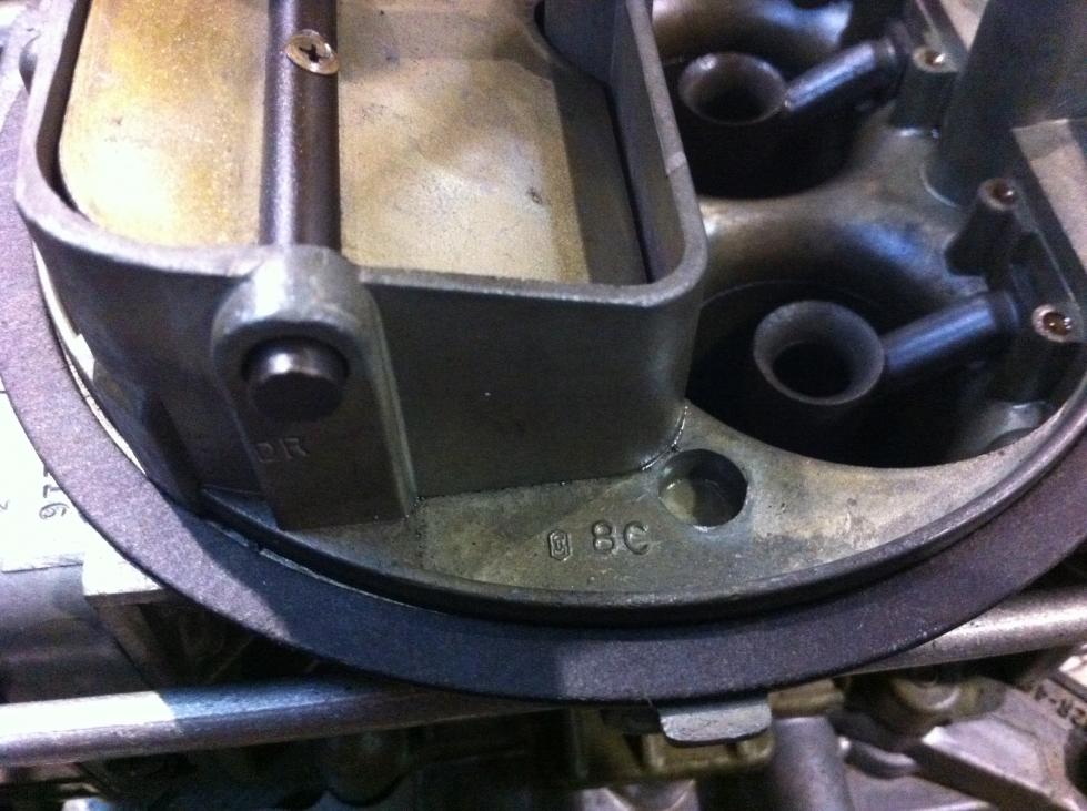

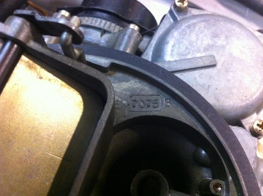

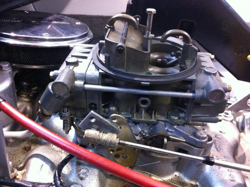

5 Attachment(s)

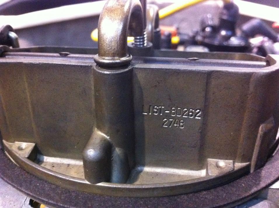

Hey guys,
On the carb (on the choke plate's body) I can read this reference : "LIST-80262".
Attachment 9405Attachment 9406Attachment 9407Attachment 9409
I find this : http://www.jegs.com/i/Holley/510/703-28/10002/-1
Is it what I need ?
Looks like the right one to me.
