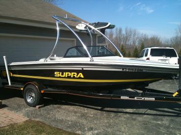

Looks perfect !!!
Look at the boat behind the Supra, it's newer but looks older because of an old and straight style tower ...

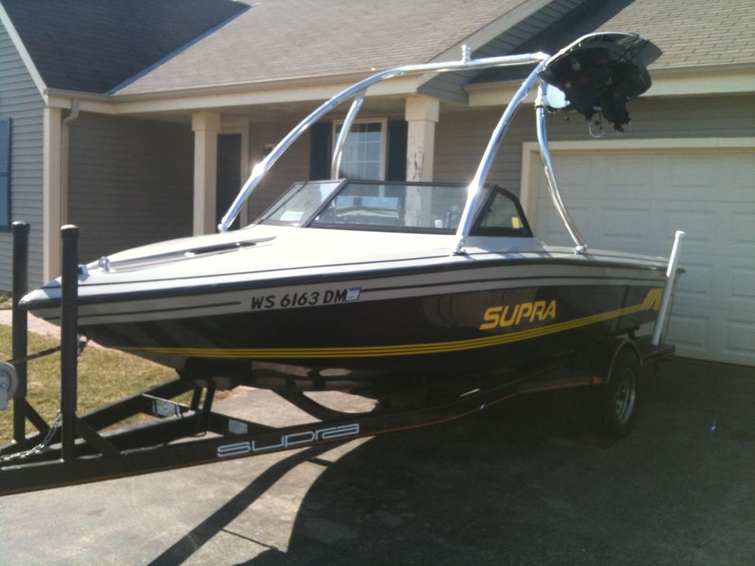

Installed my tower tonight, i will post some pictures as soon as I get her on the water
Any word on the tower
How does she look
I am thinking of ordering the same tower would like to hear how yours is first though.

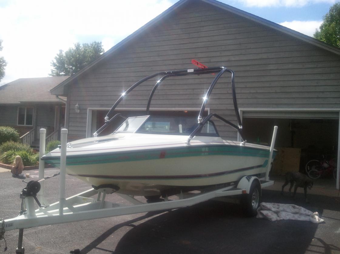

Put a Aerial Airborne on my 88 Comp and I like it. Put it on myself in about 3 hours. Attachment 9057

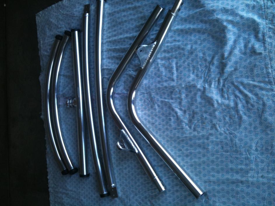

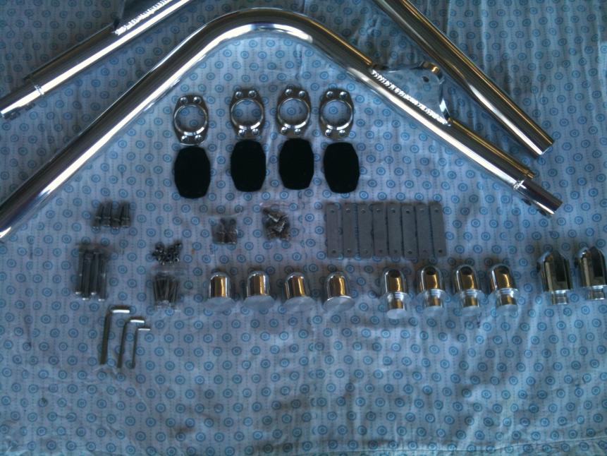

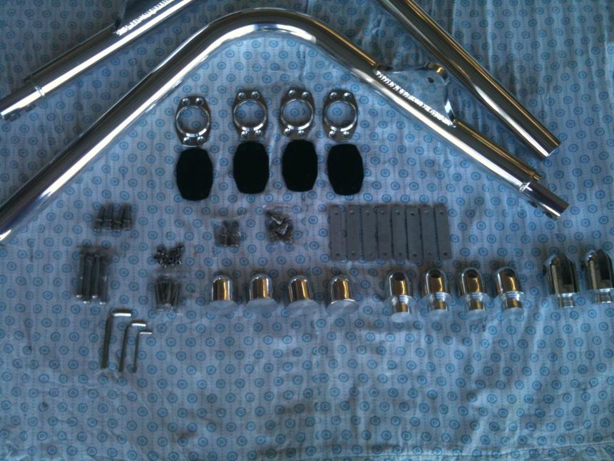

here are some pictures of the tower in pieces, the directions say if your boat is under 3/8 inch thick in mounting locations to reinforce it. the backers are the 8 small rectangles. so i made some 4 inch round circles for my backers. i think they will be much better. no pictures of them, sorry. havent tryed it yet, probably tomarrow after i wax her and put the freeze plugs back in
