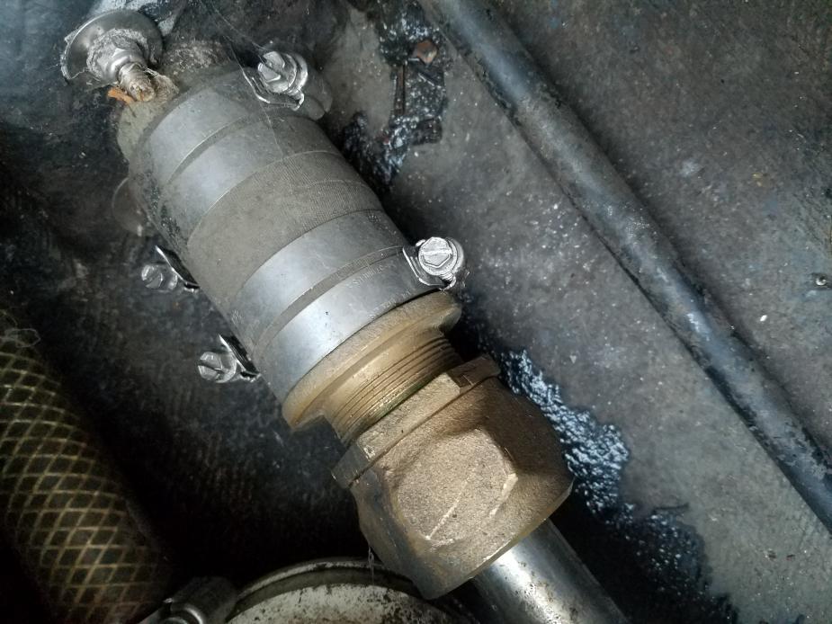

Got to lake test my new-to-me 2000 launch last weekend. I crawled around all over looking at stuff... While underway I noticed a little more than a drop a second coming from the end of the big brass nut. I searched around and found a conversation that said 1 drop every 15-30 seconds.
I though I'd trying tightening the packing before replacing the stuffing. Im hoping somebody has done this and might share a procedure based on the pic? Any comments are much appreciated!
get some big pipe wrenches or similar and loosen the thinner locking nut. then tighten the big packing gland nut until the drips reduce or stop. then tighten the locking nut against the gland nut while holding it
Thanks Docdrs! I get what you're saying. I'll give it a try this afternoon.
Just an addition...the manual says you should be able to adjust the large nut by hand. If you have to use a wrench to slow the dripping, then it is time to make plans to replace the packing.

Adjust maybe 1/2 a flat at a time and then retest. If it needs a bunch of tightening, probably needs to be repacked. It's not hard. Skidim has the wax string and Goretex packing material. Your packing is going on 18 years there. Probably dried out.
Just do 1/4 turn at a time. In theory you shouldn't need a wrench but the facts are that you will need one. even if you need to replace the packing it's like most things. Easy to do but a pain to reach and see.
I bought 2 spanner wrenches to break the jam nut loose. Took everyone's advice and only tightened slightly, about 1/2 a flat spot at a time. Ended up turning 1 full flat spot total to get down to a drop or 2 every 30 seconds. This was done by hand and underway at an idle. Then used the wrenches to hold the stuffing nut in place while tightening the jam nut good and tight. Article/link warned if the jam nut isnt tight you could spin the stuffing nut off while in reverse. The spanner wrenches are nice because they are thin and fit in there next to each other!
