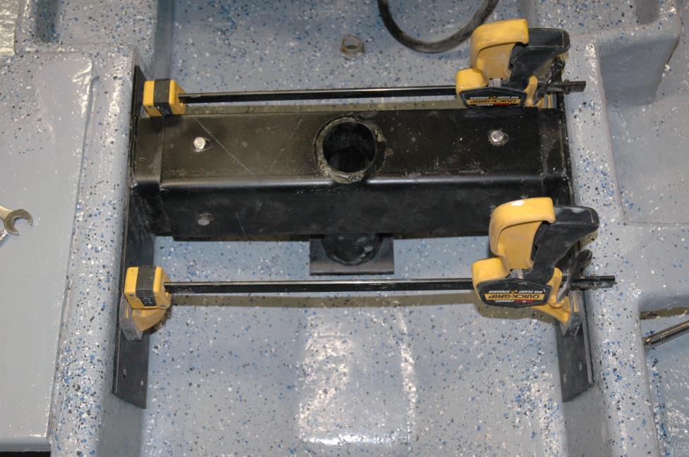

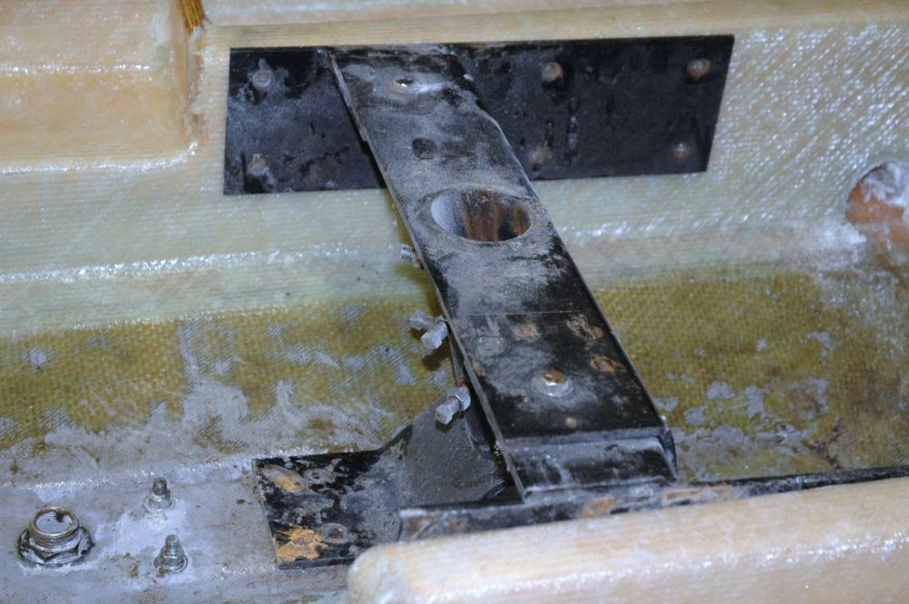

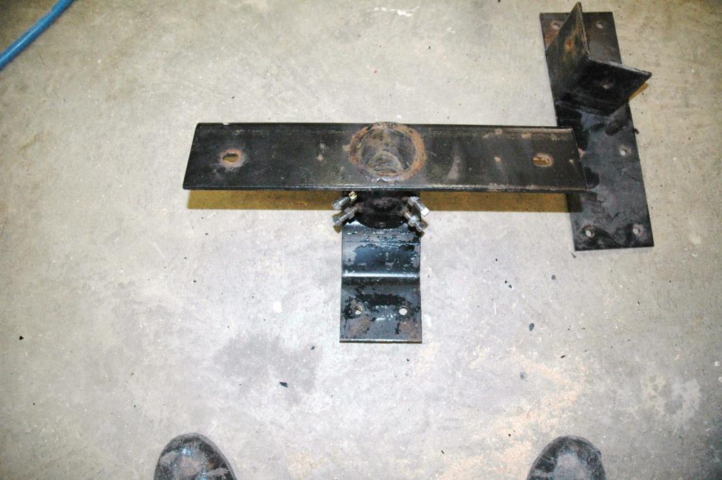

3 Attachment(s)

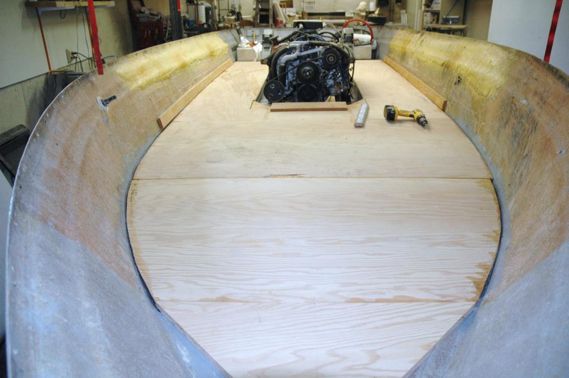

Here are a few of the errors I made. I decided to replace the 1/2" factory flooring with 3/4" marine plywood. In doing so, I reduced the stringer height by
1/4". This exposed the ski pylon bracket above the top of the stringer. I used a press to flatten out the bottom flange so the bracket would fit under the floor.
Attachment 14494Attachment 14495Attachment 14496

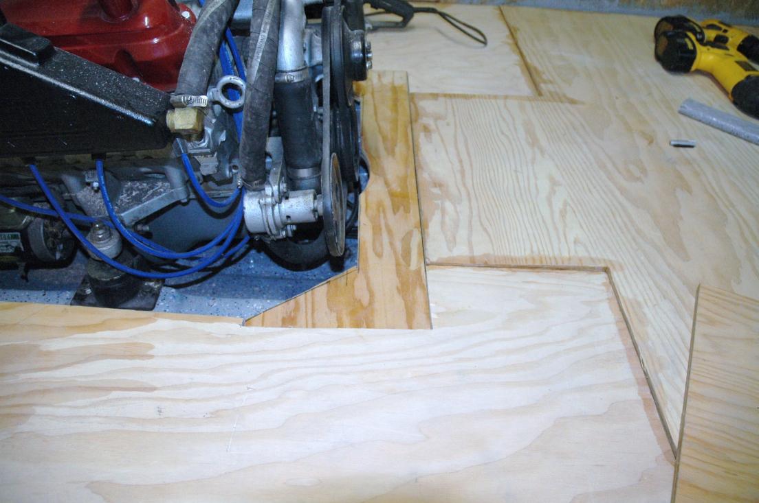

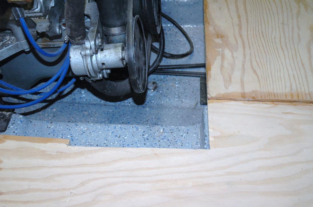

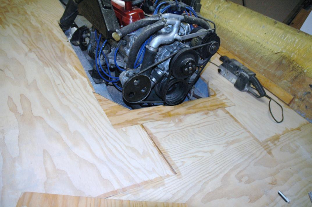

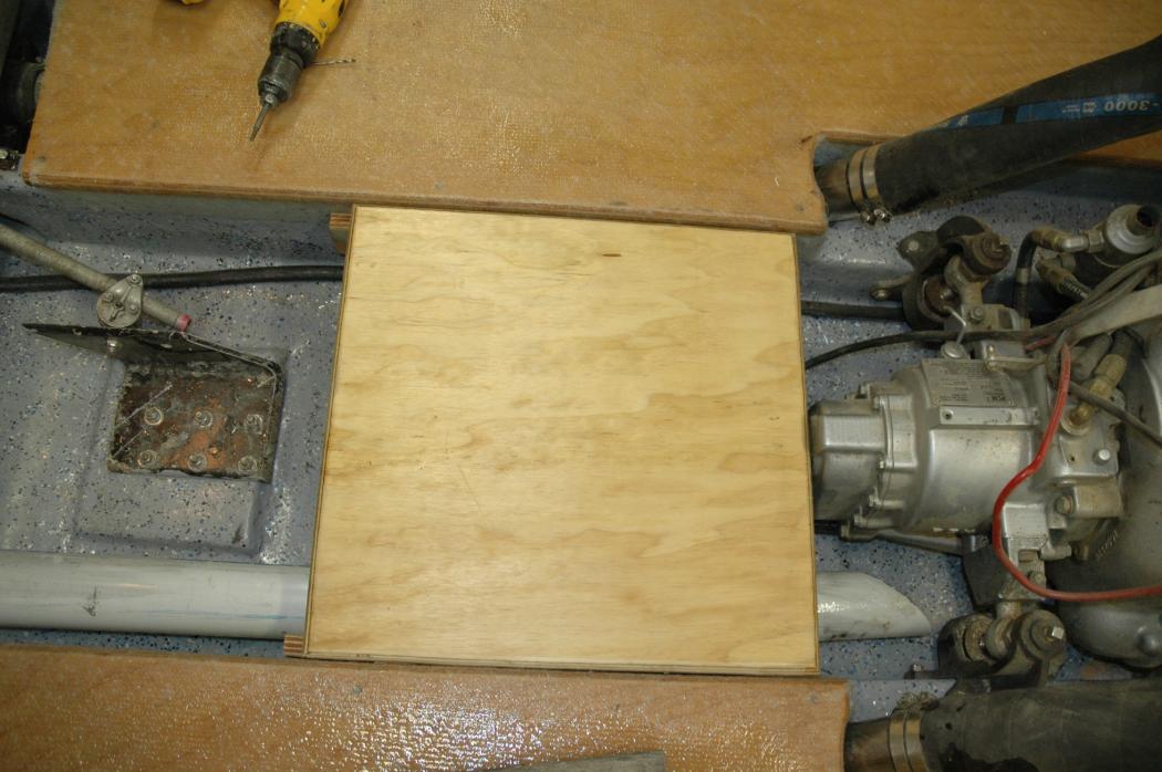

5 Attachment(s)
Another error is when fitting the floor, I cut out a square under the motor box. The floor is actually angled toward the front so I had to create an insert. Once again, more CPES.
Attachment 14497Attachment 14498Attachment 14499Attachment 14500Attachment 14501

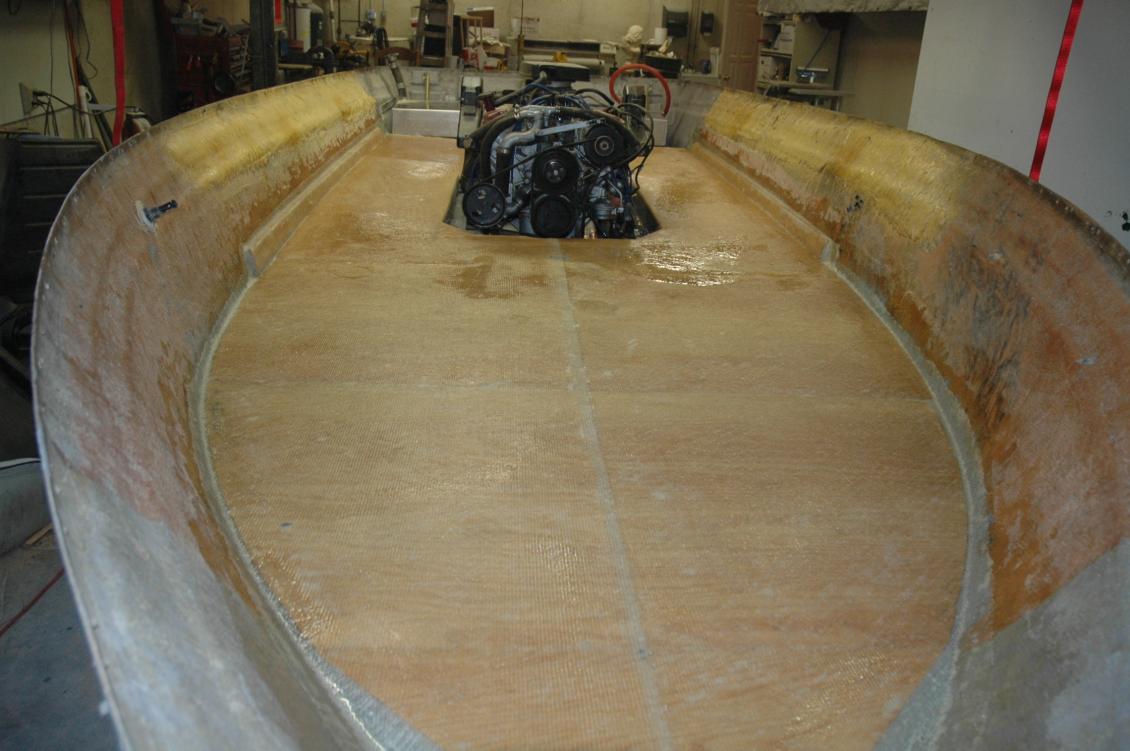

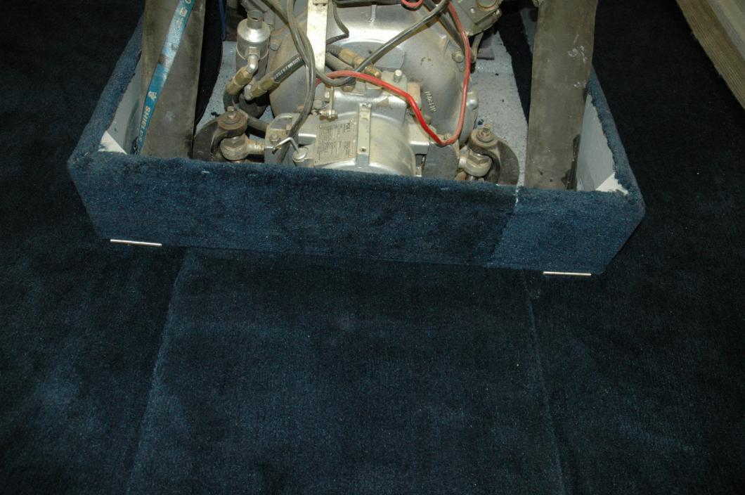

5 Attachment(s)

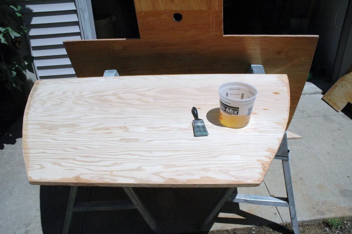

Top of floor gets glassed in. I did not allow for the thickness of the carpet when fitting in the inspection cover over the prop shaft. I had to trim the width then re-attach the carpet.
Attachment 14504Attachment 14505Attachment 14506Attachment 14507Attachment 14508

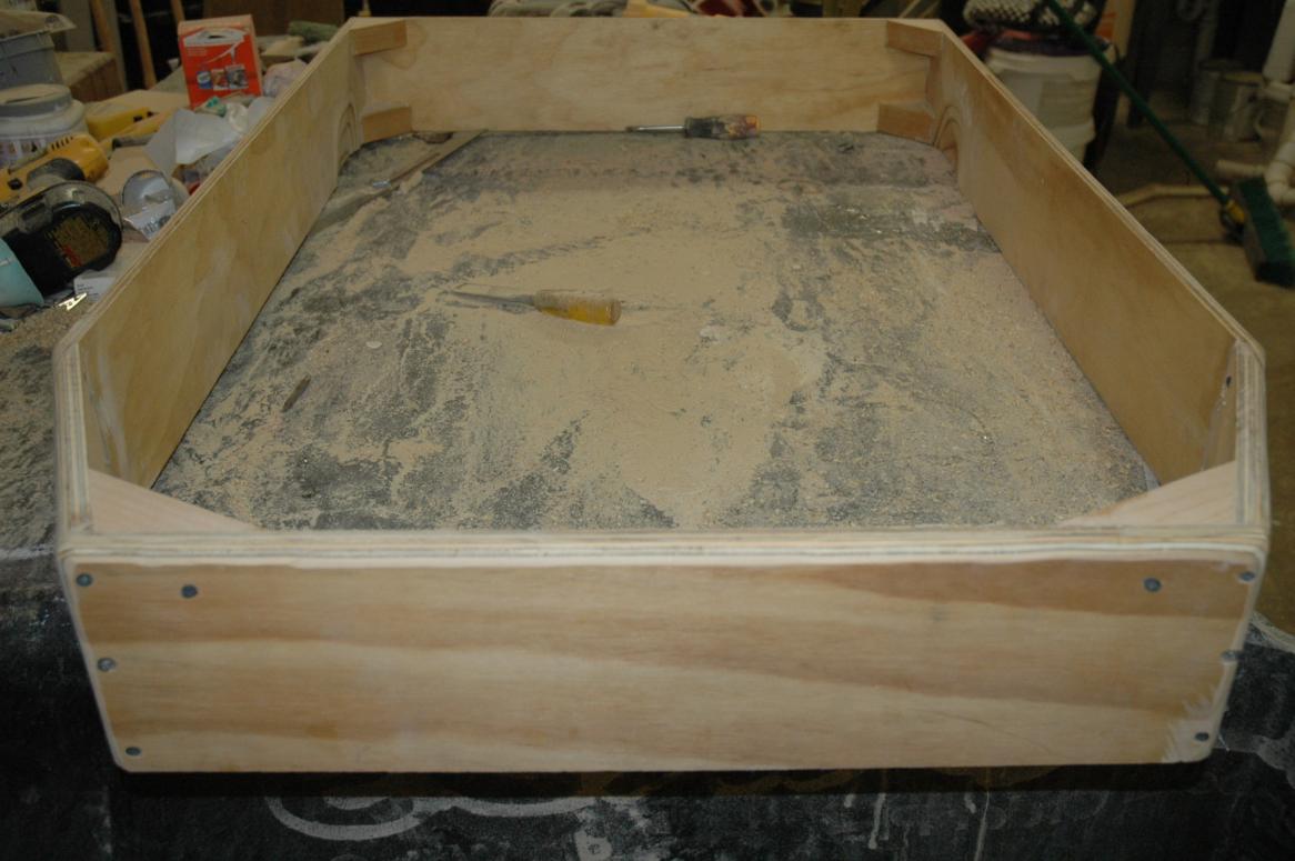

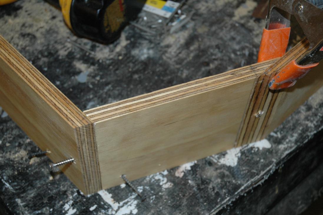

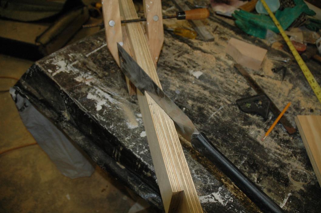

5 Attachment(s)

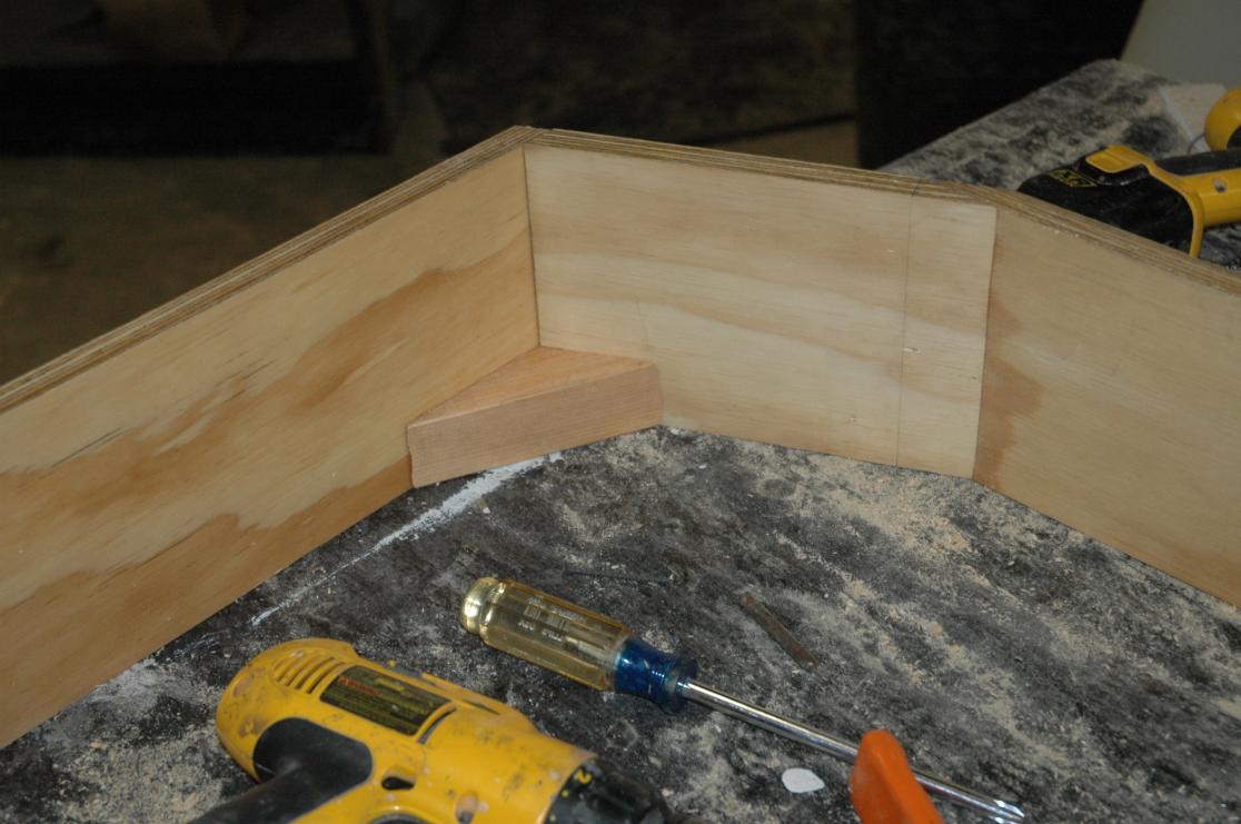

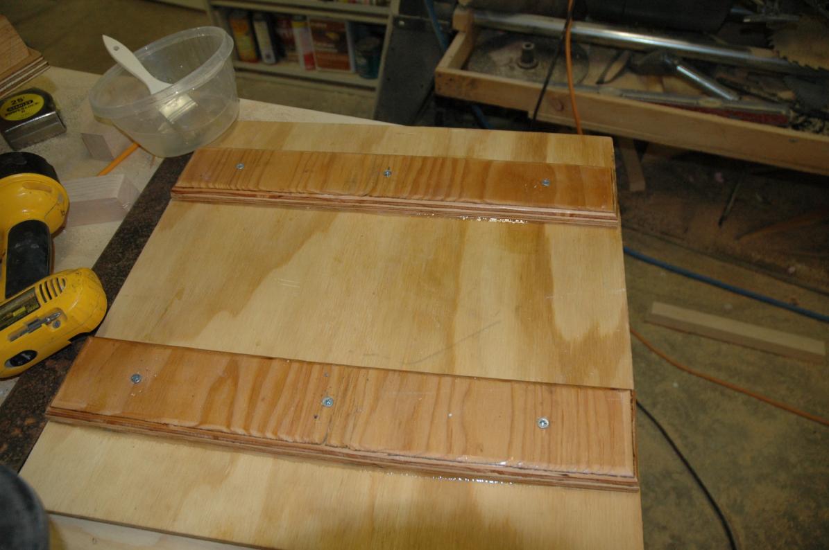

Next project was the motor box cover. The factory used butt joints and staples. Mine came out as more of a lap joint for a larger surface area for gluing.It was easier to cut the large angle by clamping 2 boards together and using a hand saw. A belt sander was used for fine tuning the edges.
Attachment 14509Attachment 14510Attachment 14511Attachment 14512Attachment 14513

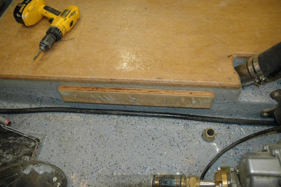

2 Attachment(s)

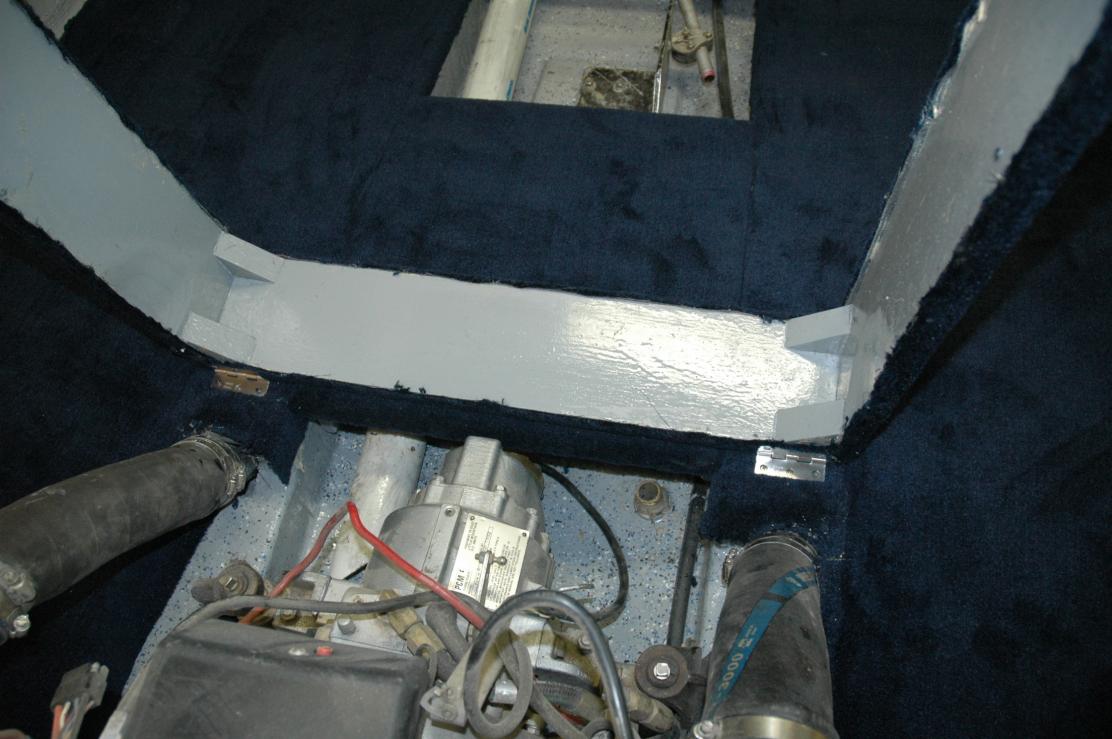

With the excepion of replacing starters, this boat has been pretty trouble free over the last 25 years. For better access to the starter in the future, I decided to use hinges to mount the motor box. This way I can lift the motor box and box frame out of the way.
Attachment 14515Attachment 14516

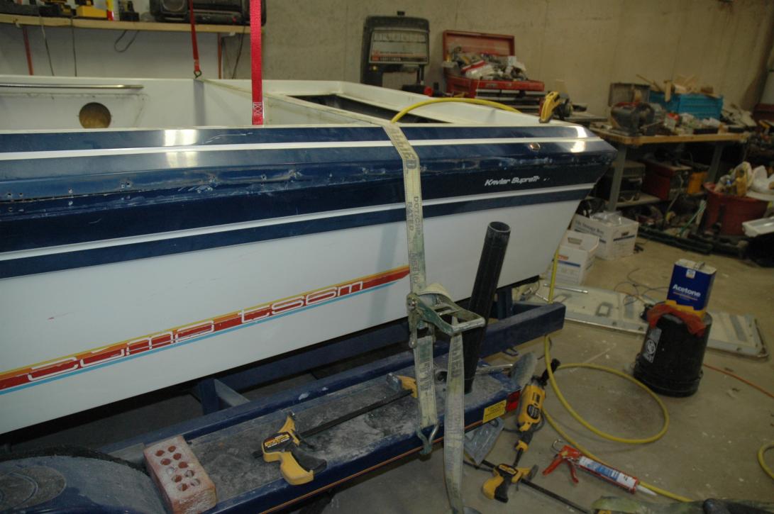

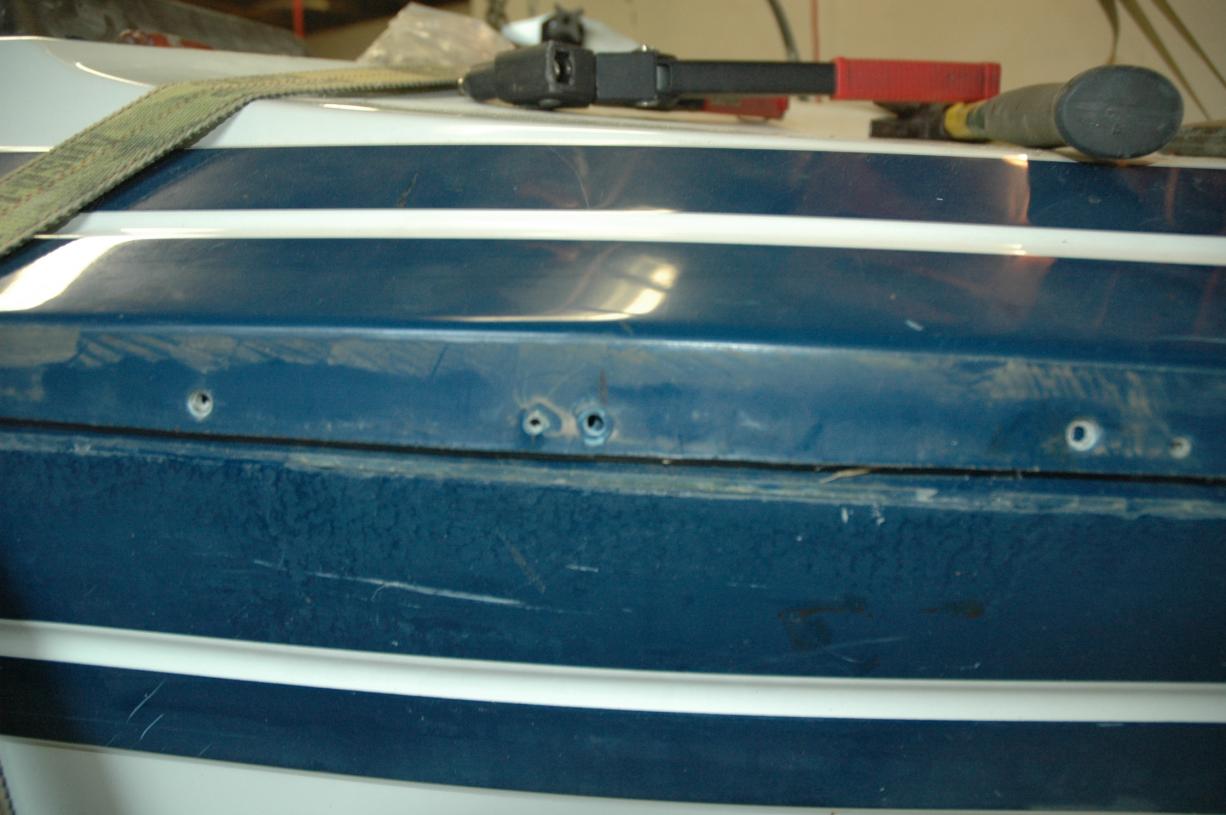

4 Attachment(s)
Lid comes back down and ratchet straps help to fit. Most of the prior holes lined up perfectly except for the front quarter. I am still baffled by this.
Attachment 14517Attachment 14518Attachment 14519Attachment 14520
