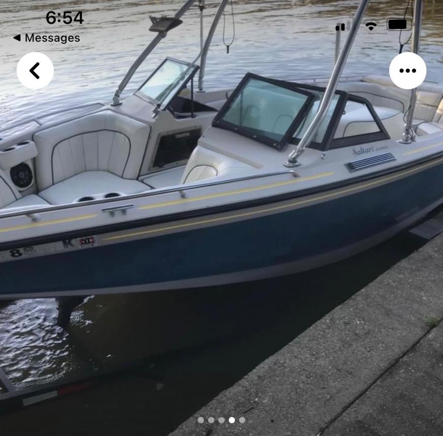

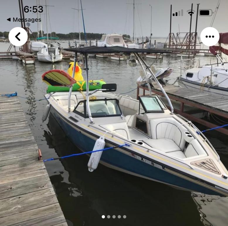

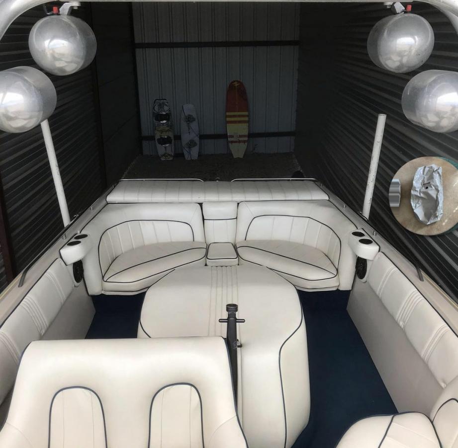

Long story short I traded a jeep wrangler for a pretty clean 1989 supra saltare. I dont know jack about boats but I consulted with someone who does. It had 472 engine hours and a foot sized soft spot at the aft port seat. Motor sounds great and upholstery looks fantastic.
All lag bolts spin except for on one motor mount. I read on here about a guy drilling out lag bolt hole. Putting in a epoxy resin and drilling a new hole for lag bolt. I know this is not ideal but for one boating season can it work? I dont want to get stringers replaced and be out of commission for months.
Does anybody have another option? Through bolts maybe? I will listen to anything a nd everything. Thank you and be kind I'm a virgin.
