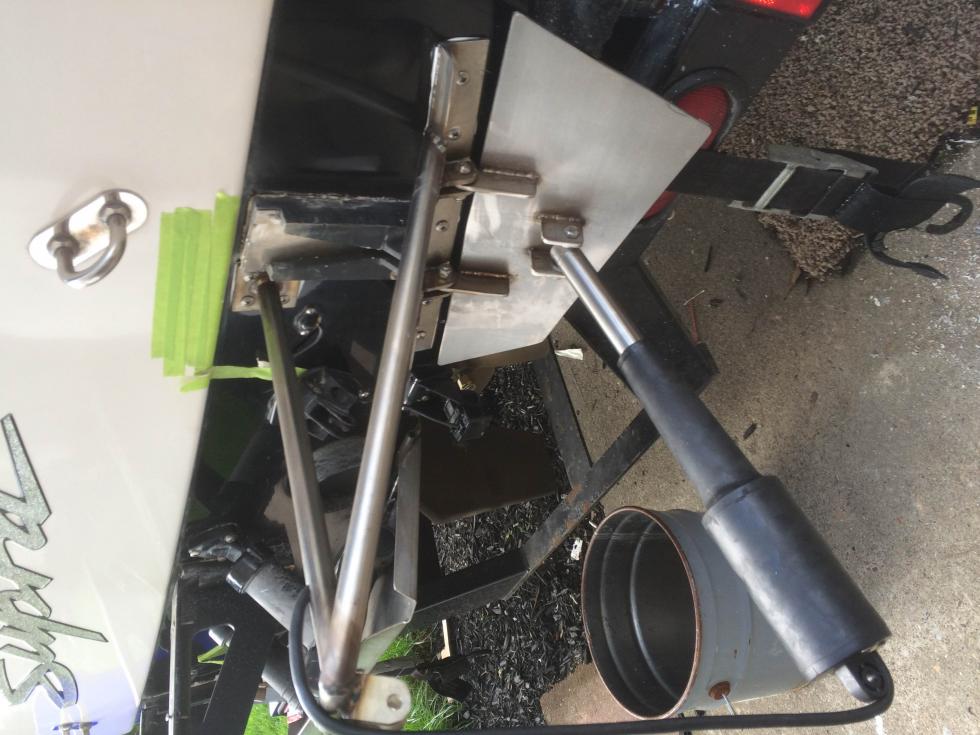

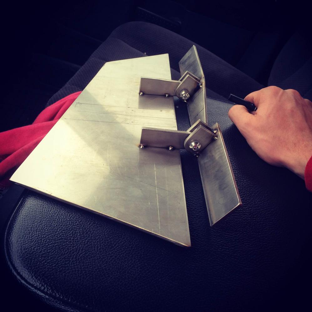

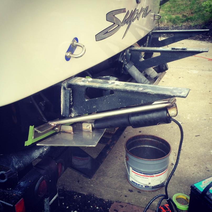

I would just skip to page 9, The thread is from all the way back to 2013 and starts with my old saltare then proceeds to my newer 2000 santera. I started with a ghetto gate but hated storing it. I then came up with a permanent rudder type design and progressed on to the vertical tabs.
Check Wakeland Manufacturing. They may have an aftermarket setup just for your boat. It'll cost around 3.5K to have it built / installed.
Yep, i definitely prefer the tabs. I like the convenience of the push button as well as the shape of the wave and the control of the steering, not only while underway but when pulling up to a downed rider. But every boat is different and every rider is different. I would suggest just whipping out a simple ghetto gate and try that first. Then progress from there.
