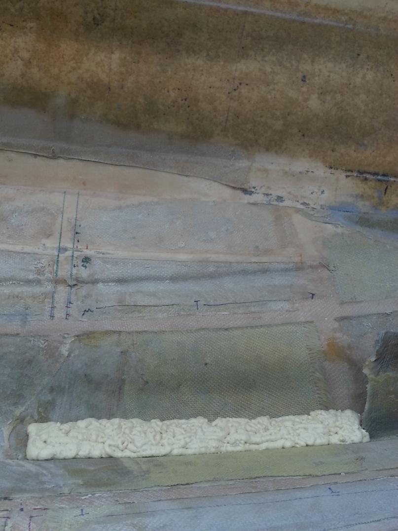

Attachment 19037 fill it with foam shape it off put 2-3 layers of 1708 over it to seal the foam
Not a bad idea either, I know I'm not going to be leaving that area inaccessible when it goes back together!
Angus has it. The lowest spot in the hull needs to be the bilge. Stop water from accumulating anywhere else.
Thanks Salty, that's the plan. Build it up and slope it to the bilge!
