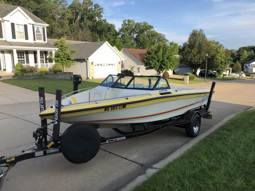

Project boat for my son. Started on it June 1st.
