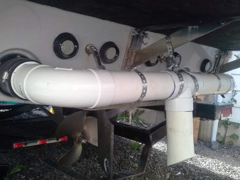

I was wondering if anyone had any idea on the best was to relocate my exhaust fumes. While I'm surfing it's all you smell. Anyone have any grand ideas? Or if this is one of the best and cheapest ways...
Attachment 18642

That picture was a version I tried on my sunsport. It FAILED. the heat and pressure actually melted and deformed the PVC. And that metal pipe strapping was just a temp solution to test it. It broke and failed as well. Pretty much that whole setup that is pictured above was an attempt that didn't work. I have the piping still thrown in the discard pile in the corner of my yard.
I did one later on my XLV using ABS and it's been effective. It's braced on the swim platform brackets. I also had to have an exhaust shop make a flange extension because there just wasn't enough surface area on the outside lip of the plastic exhaust flanges for the couplers to stay attached.
