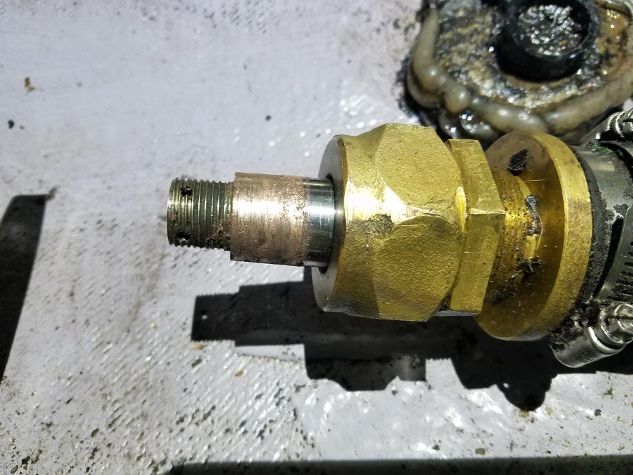

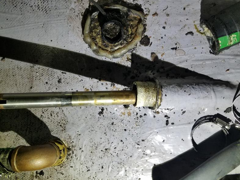

My '89 Sunsport 351 PCM is at a decision point. We got the bottom repainted and back on the water this week. Top end was terrific and it was happily purring along at 38 mph (last year with scum on bottom WOT was 32ish). Then the drive shaft separated from the coupler. We got it back together and idled home. The coupler and transmission were 3/16" off to port. The drive shaft was clearly to port in the shaft log and the strut seems a little bent. We put a wrench on the motor mounts and they all feel pretty loose. We don't remember hitting anything last year, and worried the soft motor mounts allowed the motor to move. So it seems the inevitable day has arrived.
