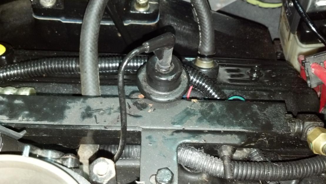

Can someone tell me what this is? is this a vacuum line? or fuel return? Just noticed it had a crack, but it appears to just be painted and the paint is cracking. The rubberish tube seems fine, but just curious if this is anything I am potentially supposed to be checking... looking specifically at the center of the pick the top hat looking thing...Attachment 10160
That is the fuel pressure regulator
Yes that is a vacuum line
I don't know the system you are working with but fuel pressure should go up as vacuum goes down.
This weekend, I disconnected the TPS since it was idling normal. The fuel then increased dumping and the RPM went up to 1100 (normally 5-700). I guess this is one way to test, but I don't think you will find yours increase in volume since it is already dumping fuel.
