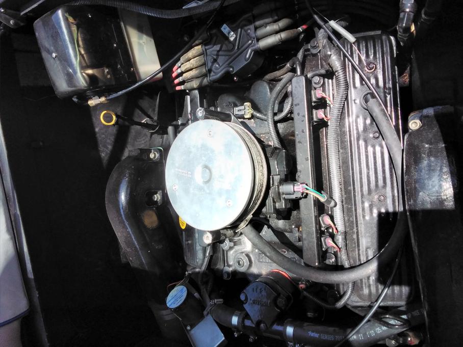

I use a prop rod to vent the motor box if the boat is sitting idle for very long between sessions with no one in it. https://uploads.tapatalk-cdn.com/202...5be12b00e8.jpg
