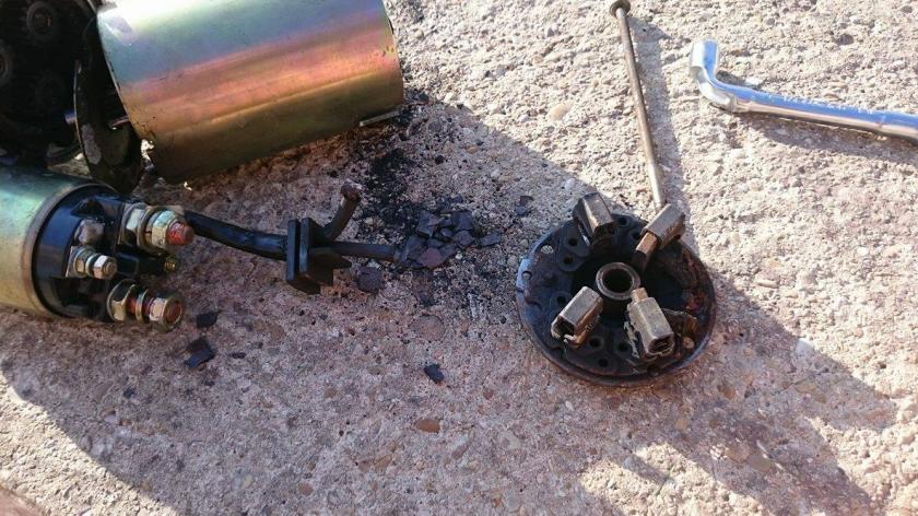

6793 dies yesterday night. Carbon brushes are very poor quality and broke in thousand pièces :
Attachment 17397
Black stuff on the floor is actually positive side brushes !

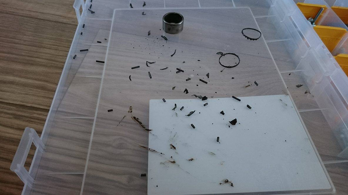

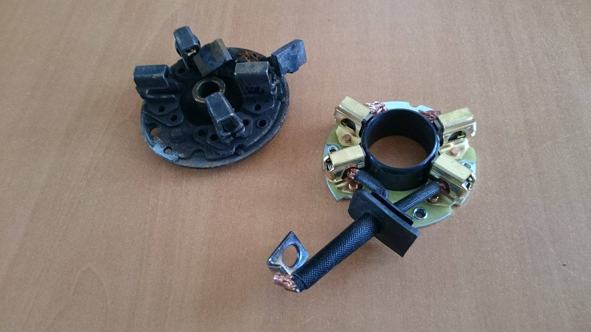

I finally found why the 6793 dies : The axle bearing exploded in hundred pièces. So, big resistance of the axle, and big overheat on the carbons. They finally broke because of that. I received a new 6793 as I could'nt find the bearing quickly, but ordered the bearing anyway, and a complete brushing plate. Now I fixed the first 6793 with german bearing and ACDelco brushings. It's now more solid than factory, and works like a truck. I have a new 6793 spare in case of troubles.
For the price and shipping price, you should go for a 6793. It's easy to fix if broken and cheap IMO. It starts the engine so much quicker than a direct drive starter and uses less ampères.

The only nylon part inside is the arm that pushes the axle. Reduction gears are iron.
The brushes kit I ordered is this one : http://www.condensateur-web.fr/couro...A2452-298.html
It needed a few adaptation : drill 2 new holes in the starter rear cover and cut 1 little centering finger on the brusking frame
Then I ordered a HK2216 bearing from SKF brand.
