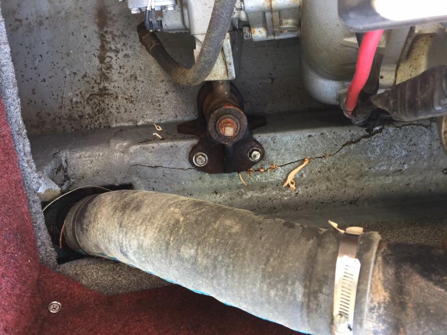

I came across a "Barn" find 1986 Supra- Sun Sport "SKIER" it has 890 hours and no major work done to Engine.
Owner said something about "replacing the foam" 10 years ago and the floor boards being replaced and New Carpet. He also said motor mounts were done. I found a couple soft spots in the floor (So I am questioning the Floor board repair even though the carpet looks new) Boat is rough, but hull and interior is in good shape......then I saw this.....Stringers look to be fiberglass, but the two on the Starboard side have Cracks in them
Attachment 18871

sunsports didn't have fiberglass stringers until mid-'92...you can tell on '92 models if they have a curved windshield that they are the fiberglass stringer model. anything '93 and up has fiberglass.
as far as this one goes, that crack looks like the wood stringer on that side split or is rotted out. they are covered with fiberglass, but still wood underneath. if he'll let you, you can take a wrench to the motor mount bolts and try to tighten them a little; if they spin, the wood is rotted out.

Those are awesome. No need for Goofy pic's Thanks for the info. I think the Stringer repair is going to be too big of a "time Suck" for me, so I am going to start looking at 93' and newer.
