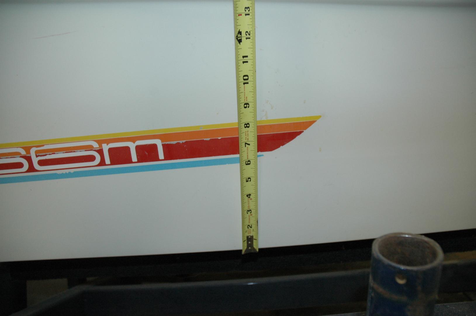

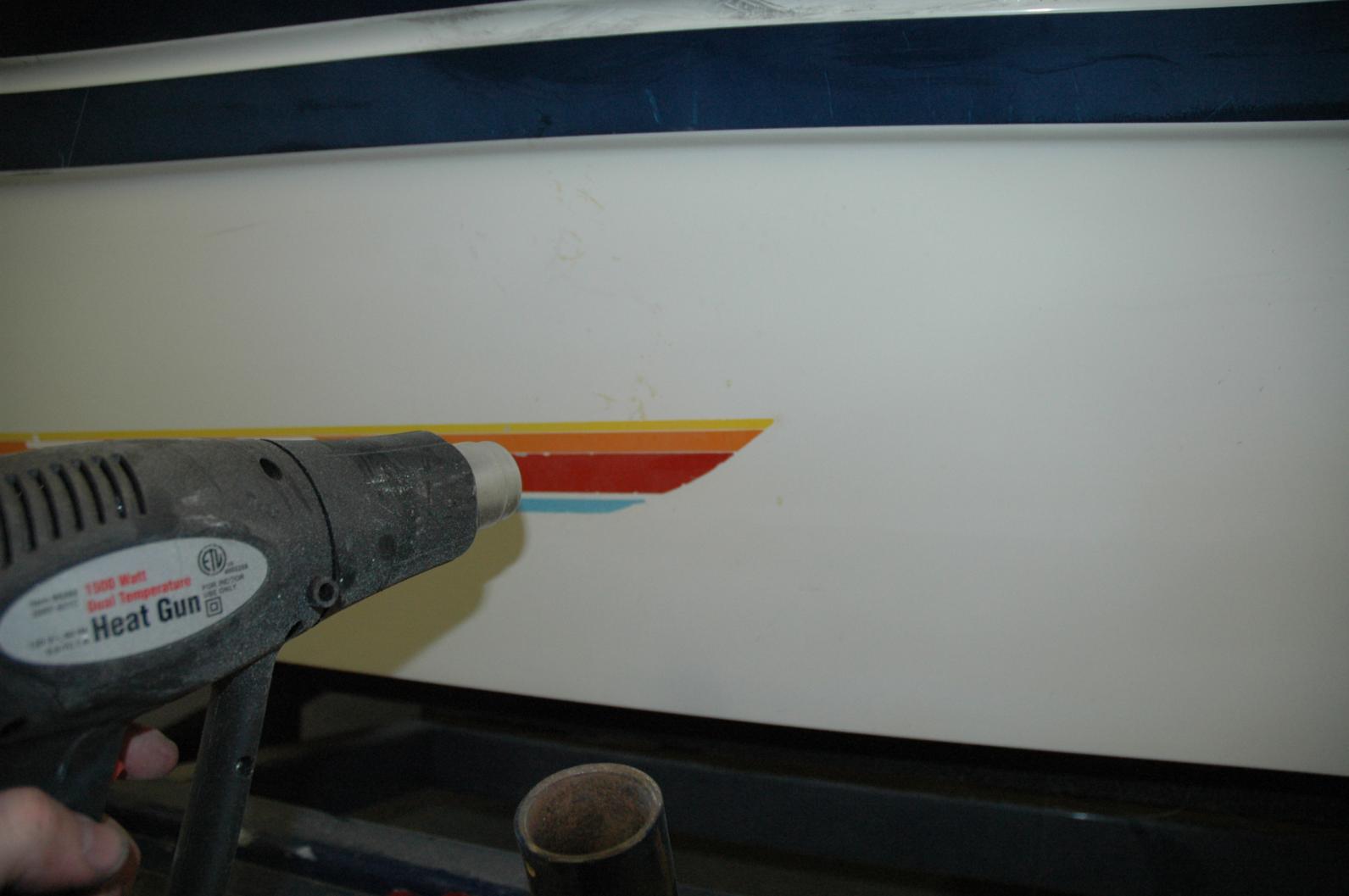

I took measurements of the stripe before removal. A heat gun, acetone, and a little elbow grease did the trick. I like the clean look of the boat without the stripe that I may not put it back on.
Attachment 14521Attachment 14522
Make sure all the rivets are gone when I put my top deck on for a fitting I got hung up by a rivet that was only exposed on the inside of the top deck. Where did you get the blue carpet?
Thanks Michael for the tip. I did actually have a couple of rivets that that were hidden.
I believe I purchased the carpet through ebay. It was a 20 oz rubber backed that matched the original pretty well. I can't remember the company, maybe Great Lakes Skipper, but I was happy with the service.
3M removal wheel for the stripe , that stuff stinks

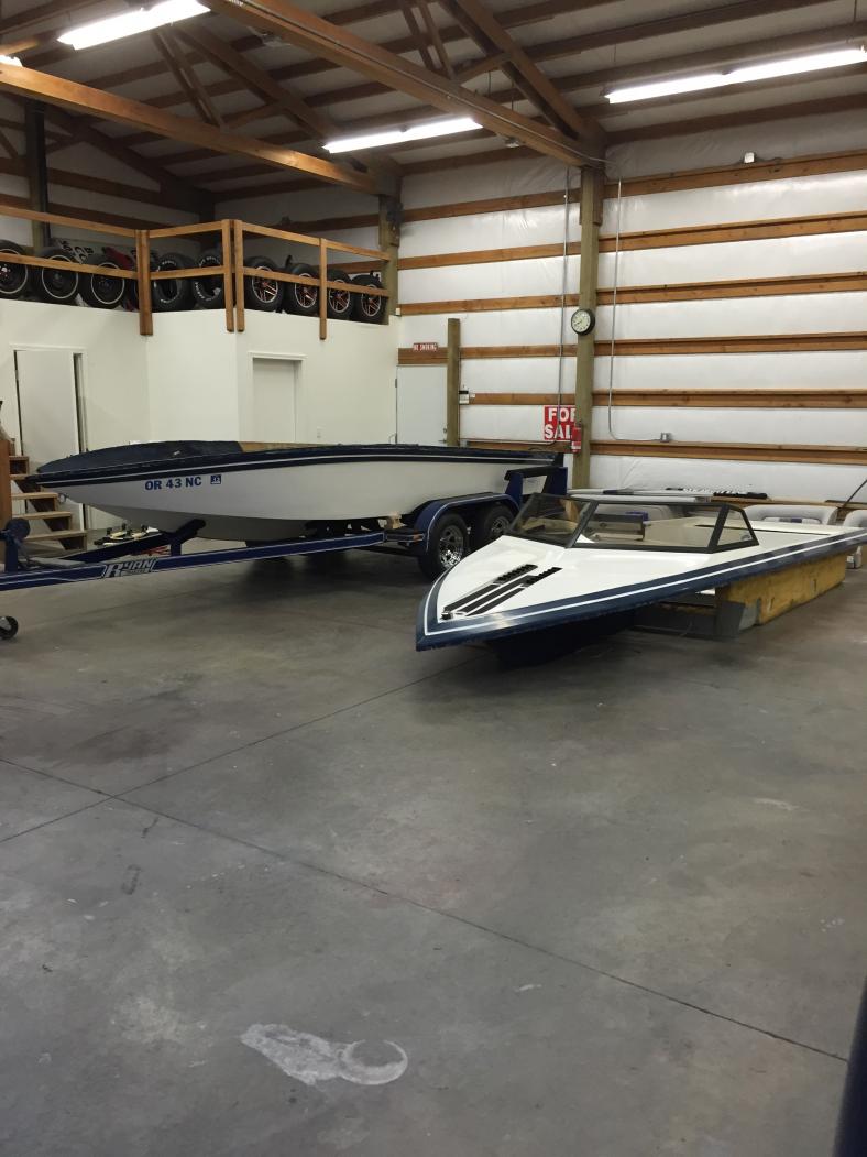

Attachment 15922
Hello, I know this is a old thread but I was wondering do you have a parts and material list you used? mostly lumber count and size and quantity of the resin?
Beautiful boat btw!!
