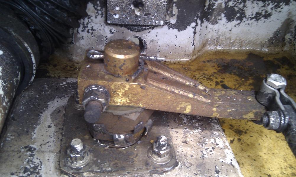

I bought a 1992 Comp in November and have spent the last few months attempting to return it to its former glory. Among the problems I've encountered is a large amount of slop in the rudder (fore & aft, left & right). Yesterday I removed the rear seat and gas tank to get to it, and I found the set up you'll see in the picture attached. I was expecting to just remove a bolt from a tiller arm which "clamped" onto the rudder shaft. Instead it's got a threaded stud, with no head. Is this supposed to thread out? Do I need to tap it out?
My intention is to repack the gland nut and put it all back together for the weekend until I came upon this mess.

You tap it with a brass or aluminum drift. Careful not to damage threads.
Thanks for the response!
How far does it need to move?
I've tried tapping it with a hammer and haven't noticed any movement. Is it threaded inside the rudder shaft?
I had the same style of tiller arm & never could get it off - could spin the tiller 360 but wouldn't come off the top of the rudder shaft. I eventually cut it off at the shaft (which turned out to not be a big a deal since the rudder shaft and housing were too far worn to be serviceable & had to replace with a new rudder/housing assembly anyway).
Only after the fatal surgery did I learn the trick - the rudder shaft has a slight curved keyway machined at a height to match where the all-thread is. The section of all-thread is located so that it just protrudes into the shaft bore of the tiller arm and has a flat machined along one side (hidden within the tiller arm). When the all-thread is rotated just right, the flat recedes into the tiller arm allowing the shaft to pass through the bore. Once the shaft is in the bore, the all-thread is rotated so that the full diameter enters the bore and binds against the rudder shaft in the keyway & the nut holds it all in place. The trick is to loosen the all-thread and rotate it just right to align the flat to release the tiller arm. You might try backing the nut off a bit & then double nut that end to give you a way to turn the all thread. Be careful banging around on the top of the rudder shaft - it's pretty soft & can mushroom, preventing the tiller arm from lifting off. Good luck & hope new packing will tighten up your slop.

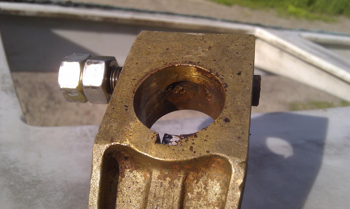

2 Attachment(s)
Got the rudder out a couple of days ago.
The trick is A LOT of penetrating oil and even more patience (let it sit for three nights) haha. I attempted the double nut, but was unable to rotate the stud. I tapped the stud a few times with a hammer and the rudder dropped right down.
The first picture is after just a few taps; the rudder had dropped about 3/4". A few more taps and I was able to press the rudder out of the rudder box. In the 2nd picture you can see the cut out in the side of the stud. There was still a bit of crud in the assembly....neglected to clean it prior to taking a picture.
