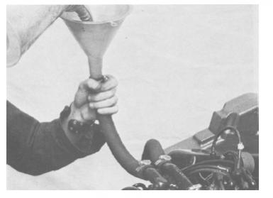

Attachment 17839
I detach the hose from water pump and pour antifreeze into the thermostat. I'm pulling the water pump anyway.
After 2 gallons or so I usually open the block drain a little to make sure there is pink coming out and I have a kid check the exhaust for pink coming out there too.
If you pull antifreeze from a bucket and don't drain the block before hand, remember that you need to run enough into the block that the water in there is good and diluted.

I like to do it like this:
Disconnect my v-drive hose from the intake at the bottom of the boat.
Put this hose so that it is bent upwards (towards the sky).
Put a garden hose in the hose.
Start engine, let it warm up.
Once engine is nice and warm, shut it off.
Drain the block by loosening the two plugs. Drain the manifolds by loosening the quick-connect on the hose between the manifolds.
Drain the v-drive and transmission simply by taking the v-drive intake hose and pointing it down towards the bilge.
Reinstall plugs, quick-connect hose and put the v-drive intake hose in upward position again.
Pour anti-freeze mix into the hose using a funnel and start the engine. Continue pouring anti-freeze down the hose until you see antifreeze from your exhaust and shut off engine. Usually takes 4-5 gallons.
While pouring the anti-freeze I usually have someone spraying fogging oil down the throat of my throttle body.
This way you can be a lot more certain that the engine is full of a good mix of anti-freeze and you will protect the engine from corrosion.
