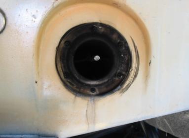

The pipes in my '87 meet the transom to within a millimeter. (see pics) I would not go to the trouble of removing the gas tank, as I did for deck replacement, just to mess with the pipes. My flange piece extends into the exhaust tube maybe an inch. I'm going to carefully re-caulk around the very small gap on the exterior of my tubes and let that cure for 24 hours. Then I'll replace the flanges and caulk them inside and out as well. My fiberglass guy did re-caulk the tubes, but I think it was one of his workers and maybe the guy wasn't diligent as the caulk sagged after application because he slapped it together wet.Quote:
Best of luck to you.
Jack
That 'caulk' job is a mess, no offense.
The flanges and screws should be bedded in sealant, not buried. The first plate seats into the flange and all that goop is just in the way. It's not causing your leak at least. This is how mine looked before teardown....
Attachment 18666
The flange curls into the exhaust tube and overlaps the pipe. Whether it's an inch or 4 inches up it's an area that needs sealant. 3m 4200 is perfect for this application but there are other sealants approved for below the waterline.
New sealant over old won't work well. Pull it all apart and clean it up. You'll see why the pipes need sealant, too.
