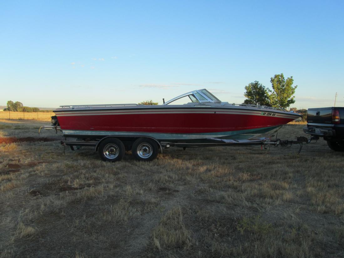

I posted last fall about converting my 89 Pirata to a v drive. I got screwed by a guy on ebay selling a BW 72C with v drive (ebay did refund my 1200.00) and lost interest in the project. Now I'm back to it!

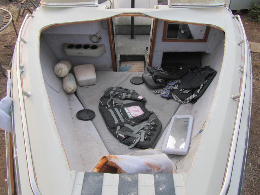

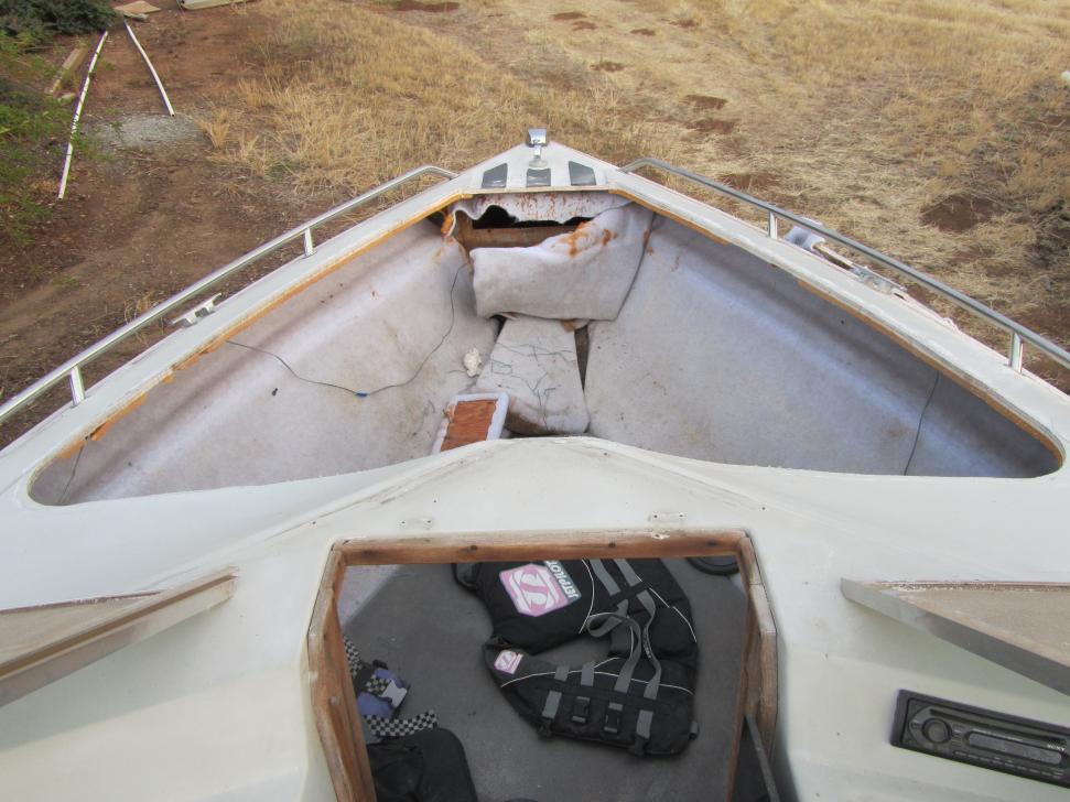

The plan is to convert to both a vdrive and open bow. I've had a few open bows before and have never liked the walk through option. I converted a mid 70's Tahiti jet into a step over open bow and loved the front "bench" seat that that offered. I'm doing the same on this hull, a step through the windshield, over the bulkhead format. I'm mounting a curved open bow windshield in place of the flat plate original and wow, it brings the look of this hull into the 21st century!

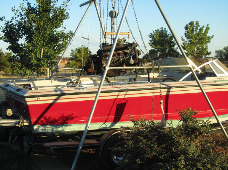

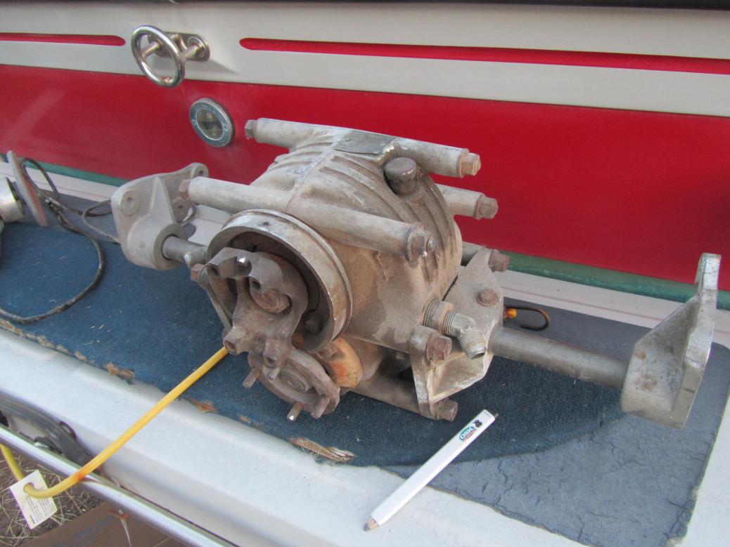

For the v drive, I purchased a Crusader unit for cheap. Its a 12* box with 15% gears, water cooled. I've pulled the engine/tranny, fuel tanks, interior, prop, prop shaft and strut. I'm now working on shimming the strut to give me the 12* angle instead of the 15* stock set up. It looks like the v drive box will be about 18" forward of the prior location where prop flange/BW mated up. With any luck, the v drive will fit completely under the floor. If not, I either fab a funky raised cover for it or build the entire floor up a bit to cover the v drive. I plan on using the original fuel tank as the rear seat base. I've purchased some Bennett trim tabs so plan on some type of trim-able wake/cavitation plate.

Question: With the 15% gear box I can go either over driven or under driven. All of the current wakeboard boats are under driven by around 25-50% (1.25 or 15.:1). I wonder with the flatter shaft angle if I can run 15% over? Any thoughts?
