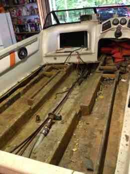

Took the heads off of my 351 yesterday to make sure it had held up well since 2007. Looks perfect. Pulled 6 years of parts and a moves worth of miscellaneous "stuff" out to uncover the skeleton of what I hope will be my running Ts6m Comp by spring. Thinking seriously about using Coosa Bluewater 20 3/4" board instead of wood for my floor. Think I could pull it off with 2 4x8 sheets (pricy at $300 a sheet, but "do it once and do it right"?). Here it is with the stringers glassed in. Attachment 12951
