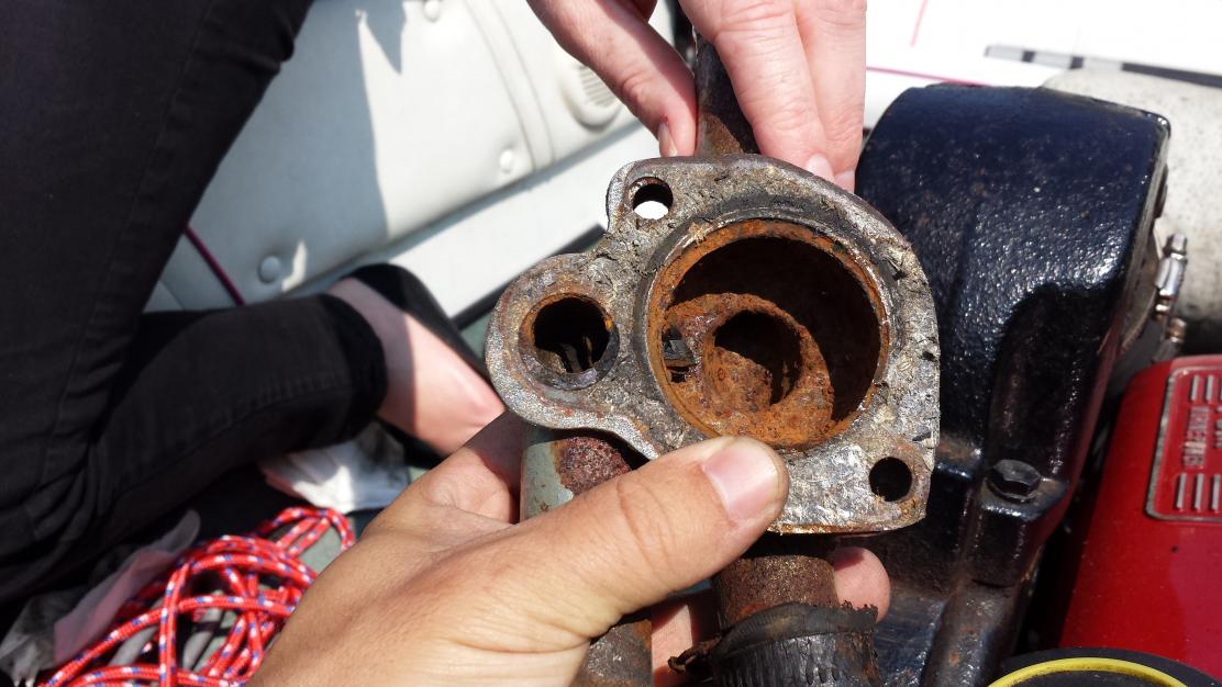

I opened up my thermostat housing a few weeks ago and this is what I Found.
Attachment 14965
My temperature control is rock steady after removing that old piece of rubber & replacing the thermostat. For those that are going to ask, it's not from my current impeller. Oh the surprises you find on used boats.
