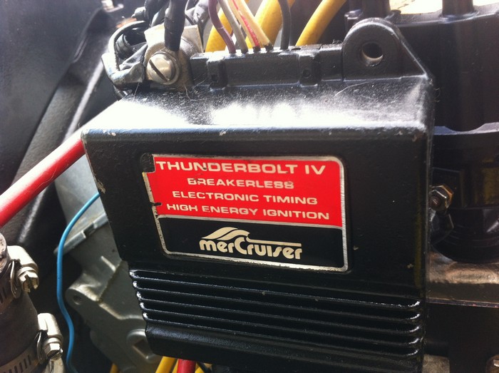

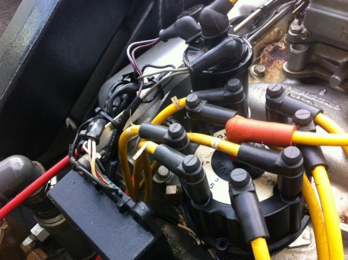

I will stay with my electronic ignition. I fixed it, 3 spark plug wire connectors were dead (rust inside, and bad connection to the top of spark plugs). It seems to not be the factory ignition system, as it's writen "Mercuriser" on it.
Here are pics :
Attachment 11139Attachment 11140

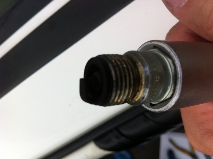

Then you can see my spark plugs are wet black. So too rich ?
Attachment 11141
I will start with 72 or 71 jets as soon as I receive it (72 says the manual).
