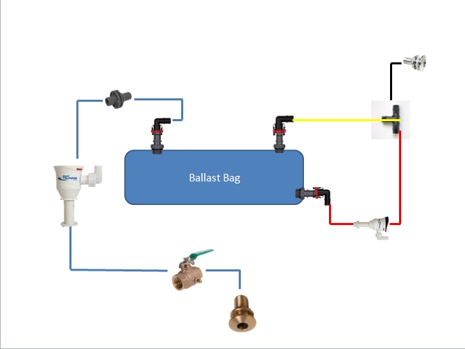

I am planning on upgrading my 2001 supra, I called WM's and talked with Spencer and he recemmed that I install two new mushroom type thru-hull intakes into the boat. I was just wondering if anyone has done this and if they had pics of the install. Just like most everyone here I am terrified of drilling holes in my boat. I have already order the parts from WM's to complete the install just wondering if it is better to make the manifold type or drill thru-hull intakes in my boat. I attached what I am going to install if you have any advice or help please let me now. -Thanks
Attachment 9906
I was recommended the same thing for my 2005 22 SSV. I got to the point where Spencer was going to put all the parts required in my cart and now I haven't heard from him in a week or so. Hmmmmm..... Anyway, what pump is that and did you go 3/4" or 1" to the bag? The pump he was recommending was the Rule 1100 with a 1" outlet but only 3/4" inlet??? It also looks like you have a check valve after the pump, I don't think he was having me put that in there. One of the main reasons for doing this upgrade was to get rid of the sprinklers but he wanted me to keep the one for the center bag. I was thinking about switching out the thru hull to a mushroom or grinding down the scupper on the original to get rid of all the sprinklers but Spencer did not think it was worth it???
He recommended using the 800's 3/4" all around to stay as factory and low budget as possible. What I was told is that you can use the rule pump that is already there and hooking it up straight to the inlet of the center bag. Getting rid of the manifold and sprinkler valves setup all together. Spencer said to put the check valve after the pump although I kind of think it is not necessary or better to install on the drain line. I am going to leave my scupper intake as-is and install two new mushroom style intakes, those two will fill the rear 750 bags. I am just at the point where I need to know what is better setup. I don't really like the idea of drilling a new hole in my boat, but if I have to I will. It sucks not being able to use ballast on your wakeboard boat!
