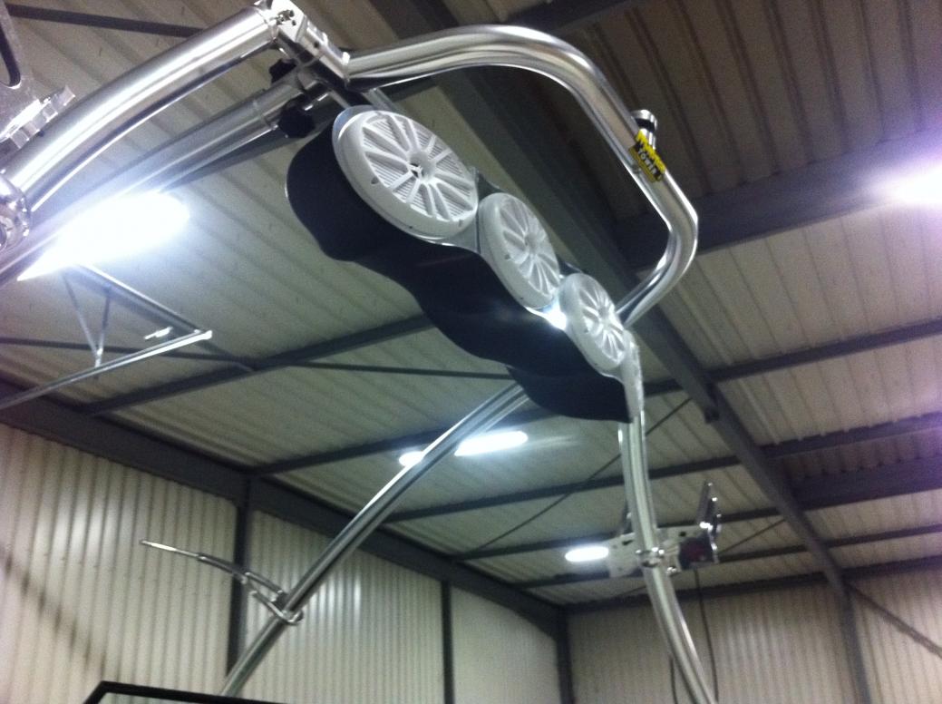

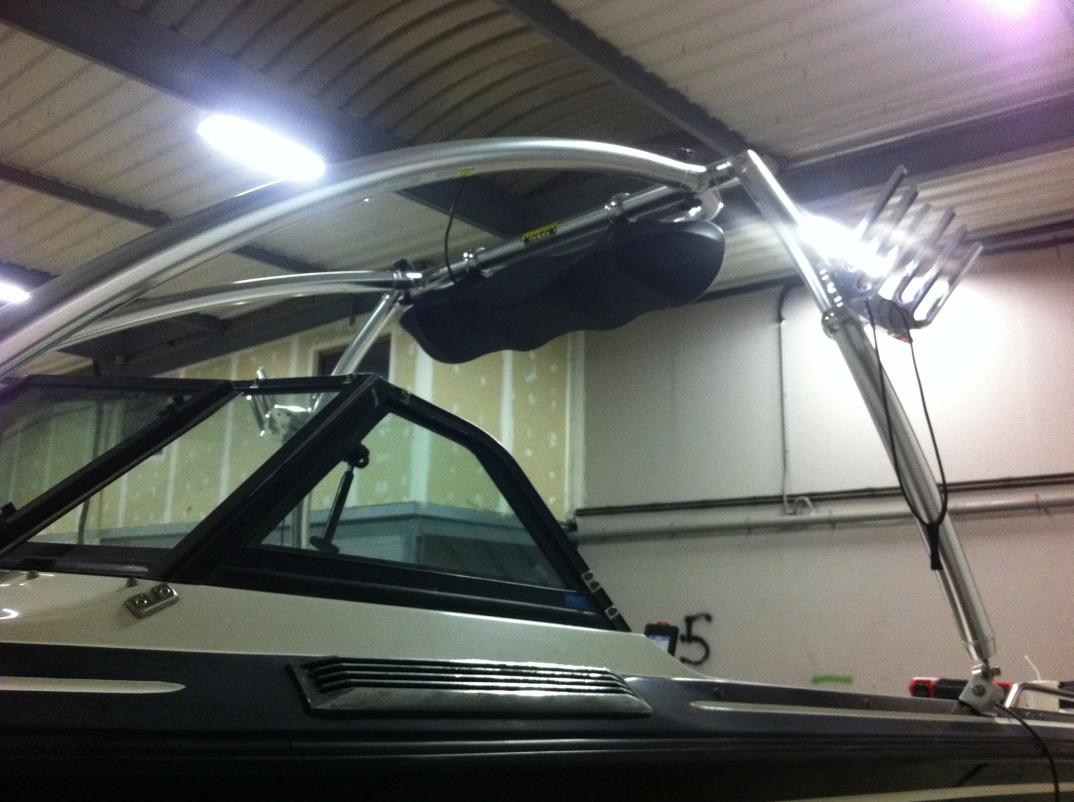

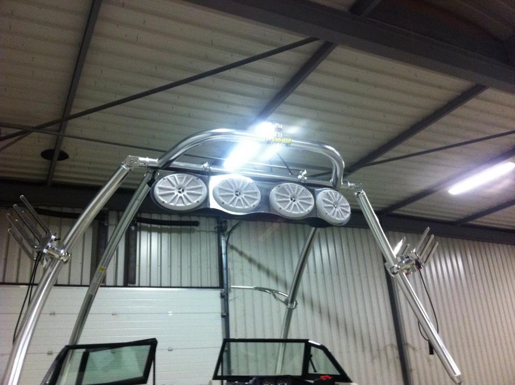

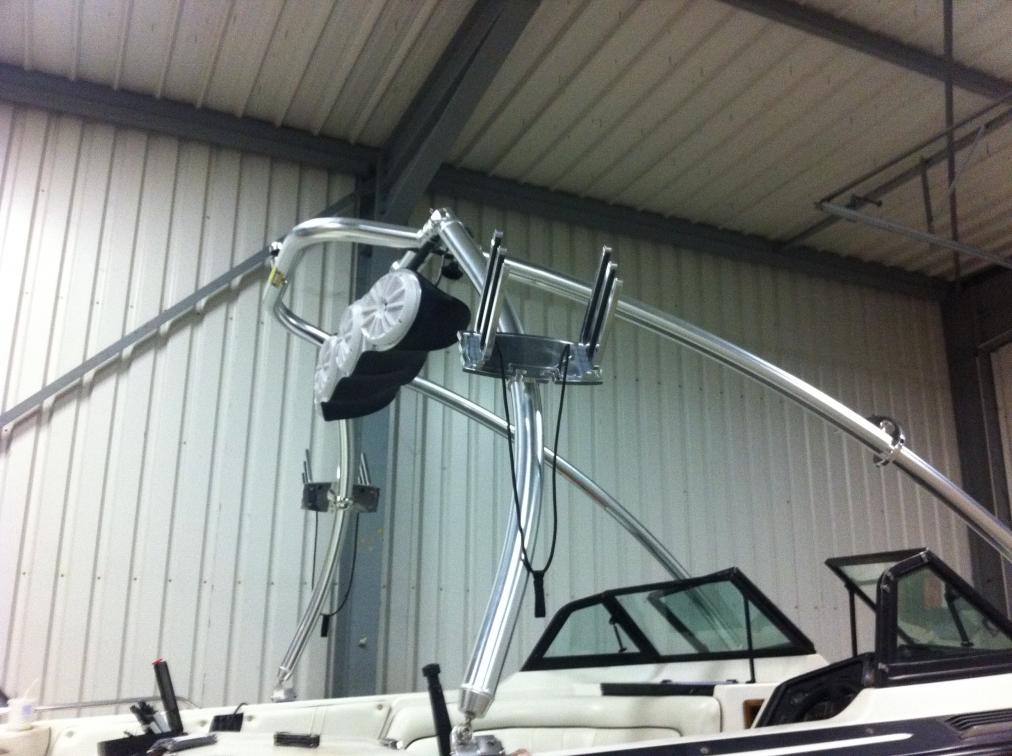

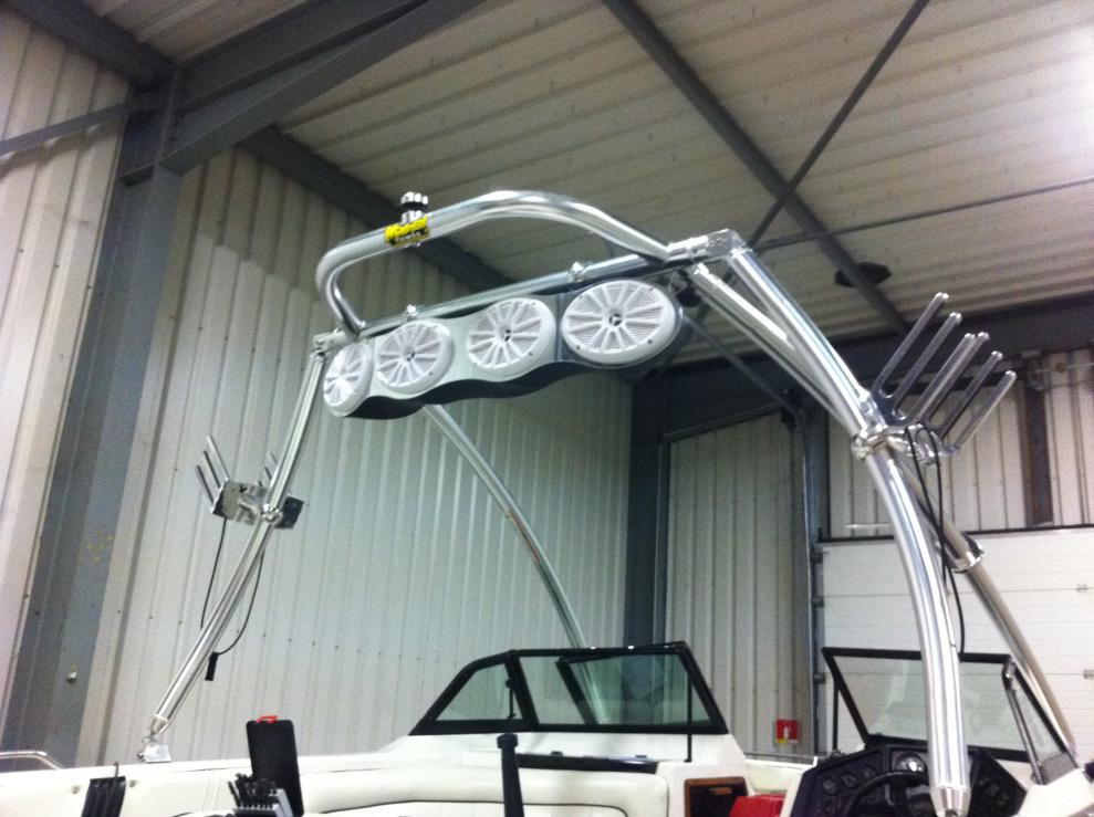

    Thanks ! Here is the result on the tower. Just need the "Supra" text on the face and it's over.

    Look great
    nice work
    I just need to get over this not wanting to put holes in my boat to install a tower.

    Thanks Century.
    I was like you with my first boat. Then you drill, and you feel better, no more scare. Anyway it's fiberglass, if you fail your drilling you can recap holes.
    The tower is a real good investment : It gives a good looking to your boat, good altitude to your jumps, and save tons of place if you put racks for boards.
    Stéphane

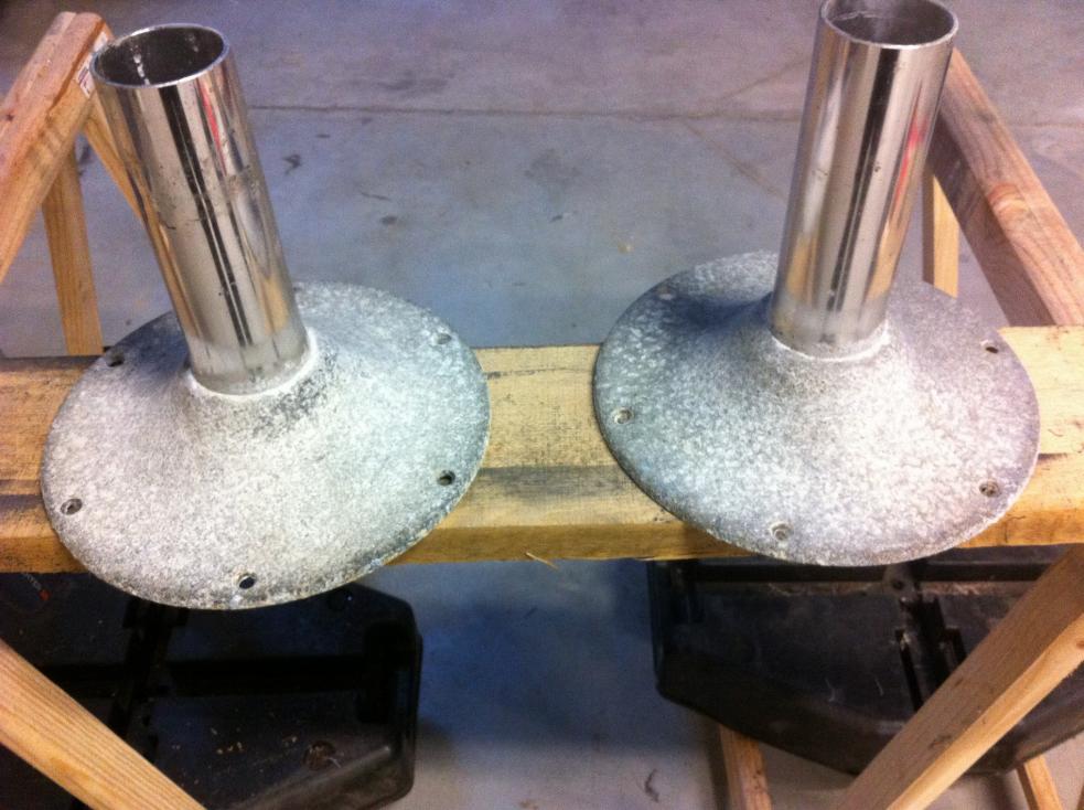

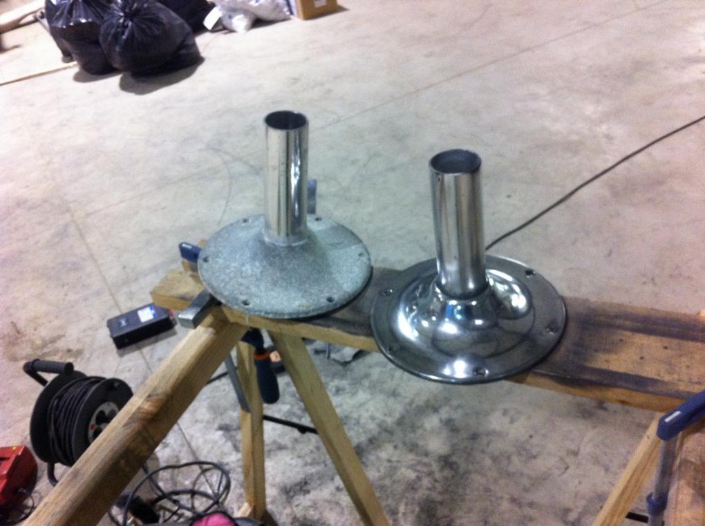

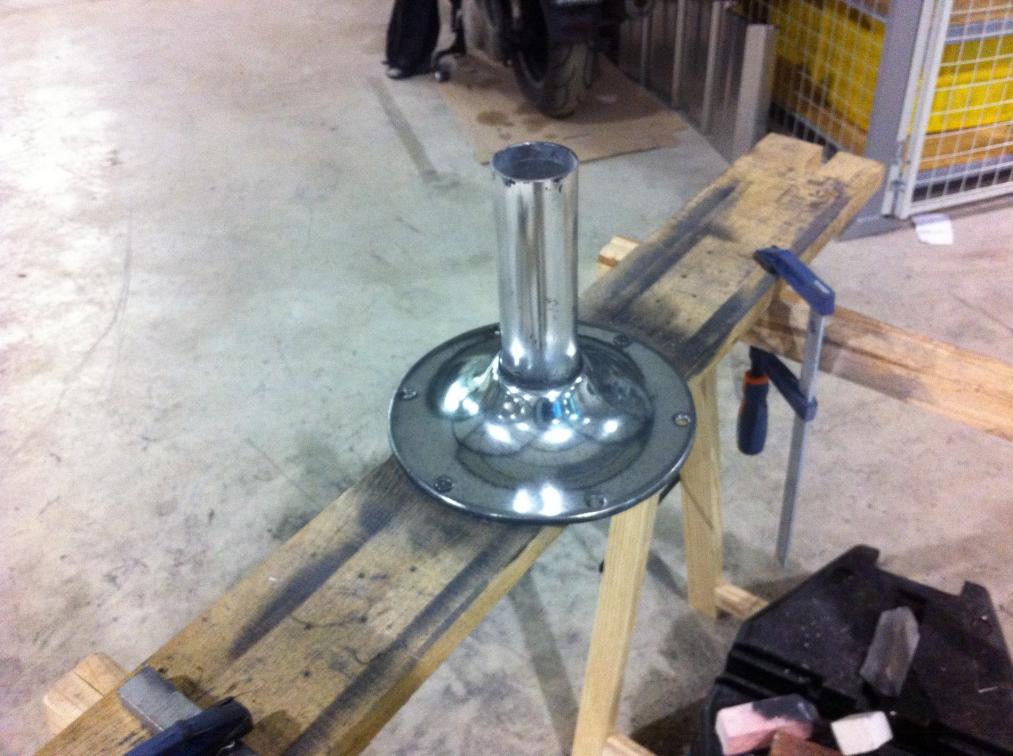

    Today I did some more polishing. These are my driver seat's feet :
    Stéphane
    1989 Supra Saltare

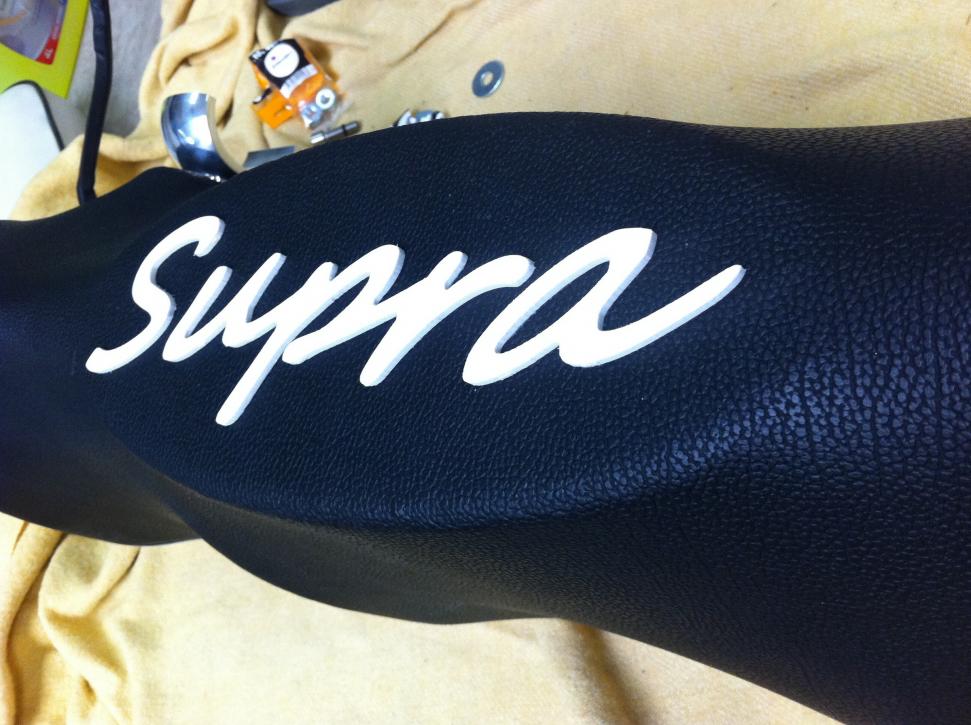

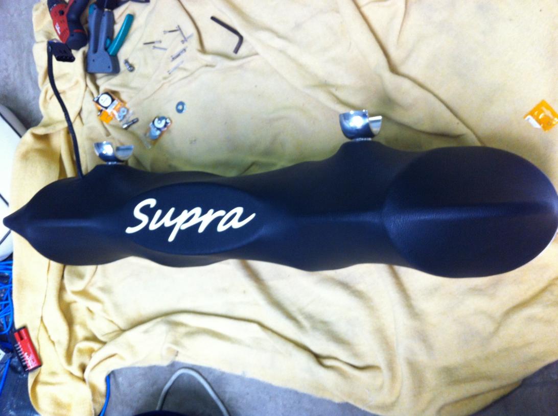

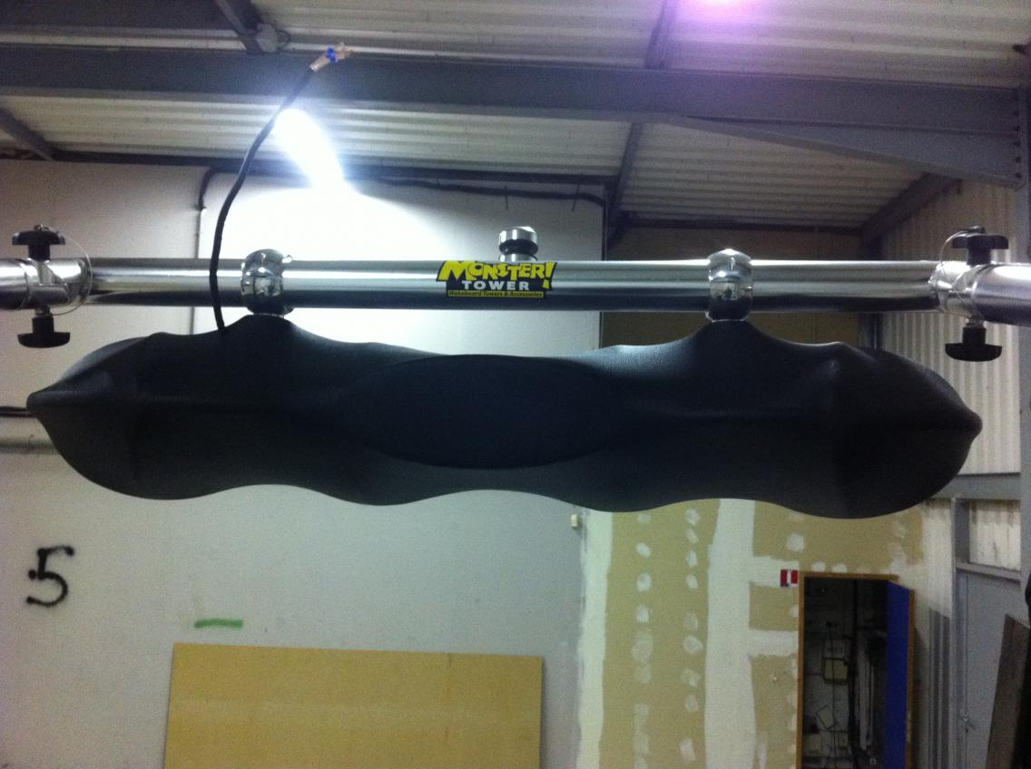

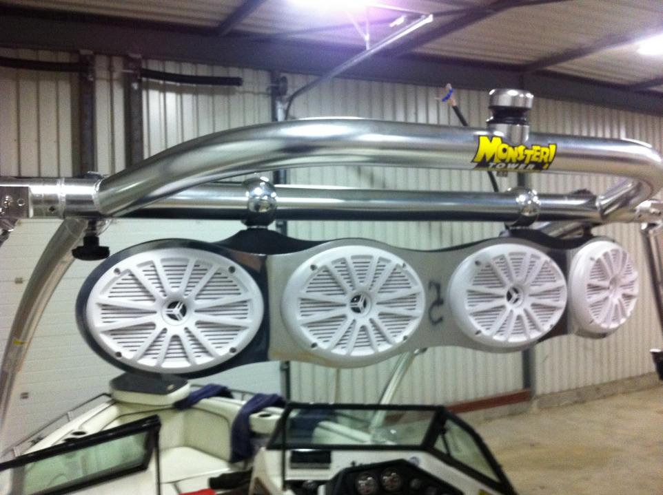

    Some updates of the weekend. I glue the letters made in Komacel 3mm, with PVC glue. It seems to be a good combo. Here are pics :

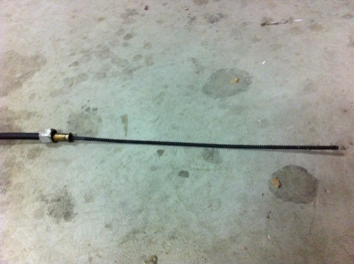

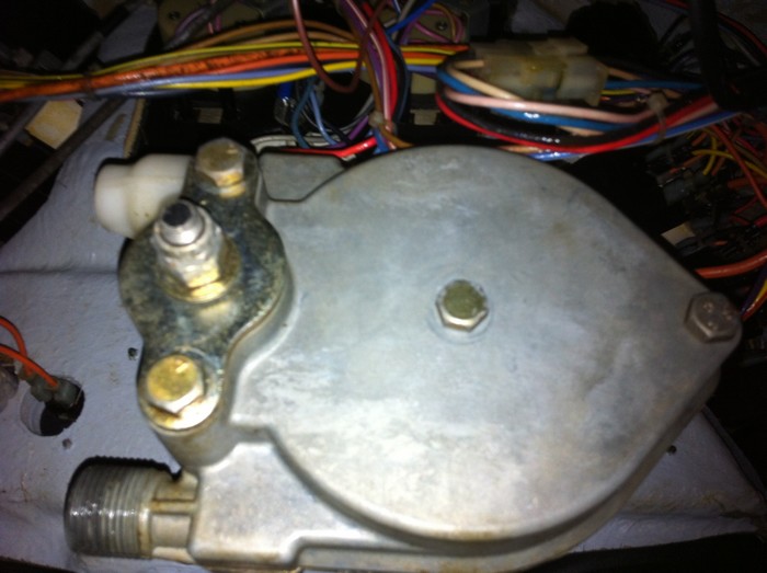

    I also remove the fuel tank to access the direction connector. First problem, the tank is leaking !!! I need to fix it, don't know how yet.

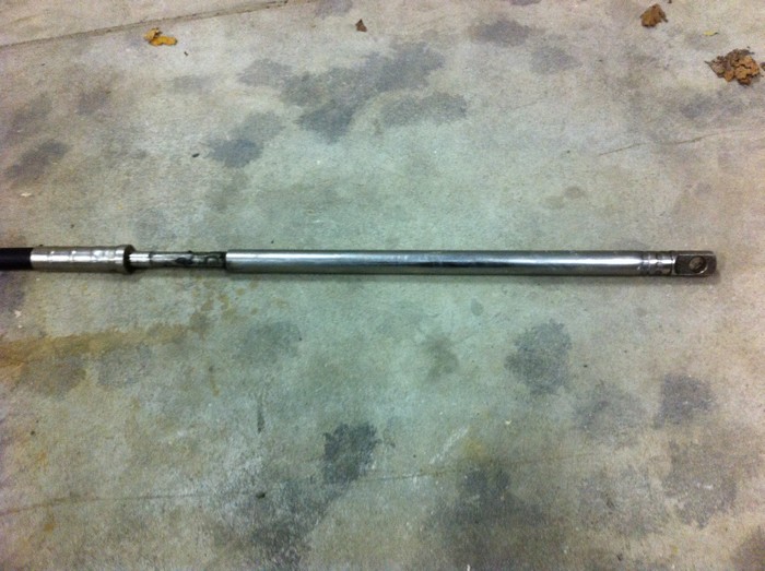

    I'm now sure that my direction problem is the cable. But, second problem, there is no any indication on it. No label, no model, no number.
    1- Can I restore it ? Remove the cable from the sheath, clean grease etc ?
    2- Does anyone know what model it is, what is reference, where to buy it ?
    Here are some pics :

    Most likely the inside of the sheath has some rust or somthing like that makeing it stiff.
    You can pull it apart or find a way to put some penatrating oil in the sheath and spend a lot of time working it back and forth.
    If you decide to replace it give these people a try http://www.skidim.com/departments.asp?dept=1120 they helped me on some rudder packing.
    I had no idea what size packing to order so I just orded both the called me the next day to make sure I got what I needed.

    Thank you, I will check it.
    My local dealer is selling Teleflex/Ultraflex M66 cables. Is it compatible ?

    And what did you use to polish those seat bases? I need to do mine before I sell them.

    I ordered a new steering cable, waiting for it to put back the fuel tank, driver seat, and to mount the subwoofer enclosure + amps.
    To polish the driver seat bases, I bought a set of polishing discs. This one to be exact : http://www.alpdiffusion.com/produit....&idproduit=476 and a driller. This is for miror effect. But as it was dirty, I first use those abrasive things to clean the aluminium : http://www.alpdiffusion.com/produit....&idproduit=546
    Hope it helps
