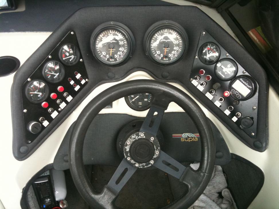

    Does your wheel look like mine? Mine is only a little off center and I have thought about getting it closer. Wonder if the "bolt pattern" would allow for that adjustment.

    Here's my dash. It's similar to yours. The bolt pattern is not adjustable. I pulled the steering wheel last winter and there's a keyway that only allows it to go on one way.
