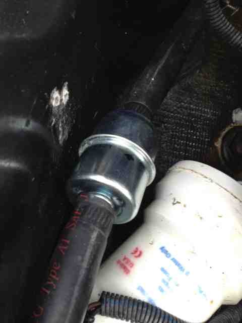

Remove the rear seat that butts against the engine and the carpeted step box covering your vdrive and tranny. It should be on the left side (though starboard in actuality). You'll see the hose running to your fuel tank. Here's a pic after I changed mine.

Yup, I don't believe your dealer would replace the in-line fuel filter simply because of a second fuel pump. The fuel filter should be in-line, on the starboard side of the V-drive. My '05 24SSV has a little holster that secures it in place and it is screwed into the wall there. I don't have the Cat engine, but I do have the 340 Indmar, I assume they'd be in the same place

On my 21V they installed the 2nd fuel pump and then i have about 6" of gas line then the inline filter The only bad part it it sits on the bottom of the boat i just replaced it because it was all rusty.
i now zip tie it up off the floor of the boat.
I would say follow the gas line to the motor it has to be between the pump and motor.
