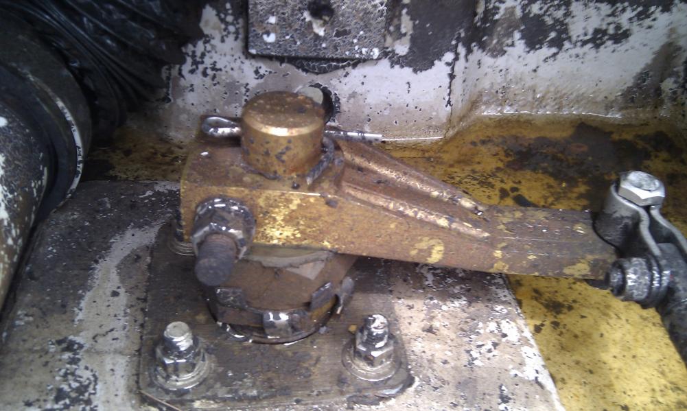

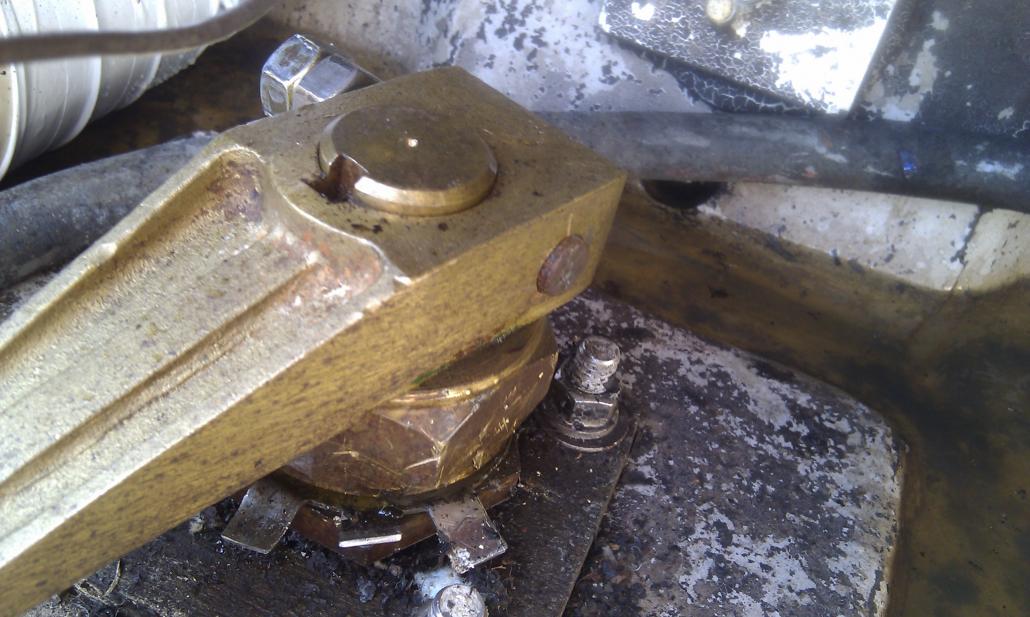

The trick is A LOT of penetrating oil and even more patience (let it sit for three nights) haha. I attempted the double nut, but was unable to rotate the stud. I tapped the stud a few times with a hammer and the rudder dropped right down.

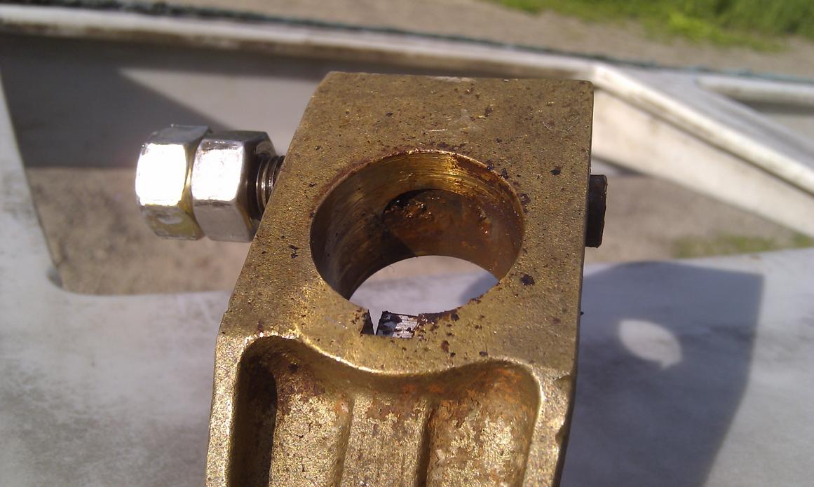

The first picture is after just a few taps; the rudder had dropped about 3/4". A few more taps and I was able to press the rudder out of the rudder box. In the 2nd picture you can see the cut out in the side of the stud. There was still a bit of crud in the assembly....neglected to clean it prior to taking a picture.
